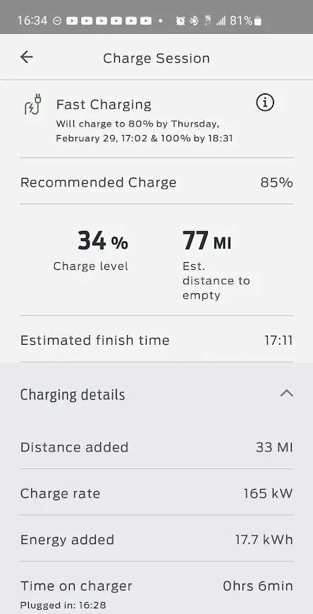

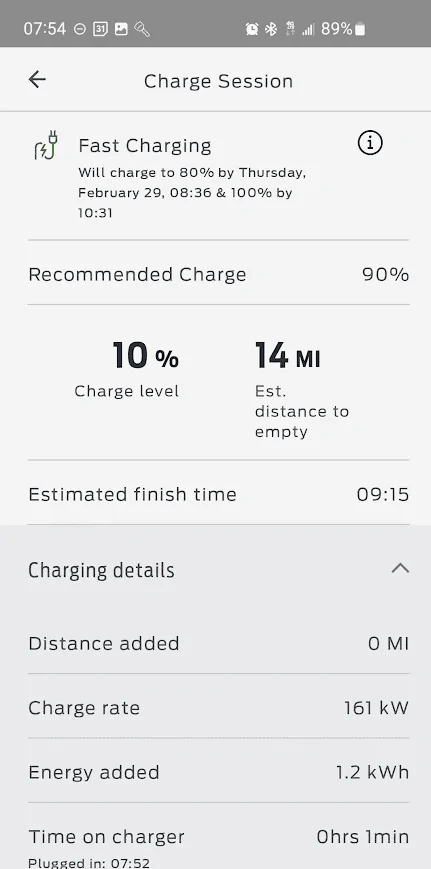

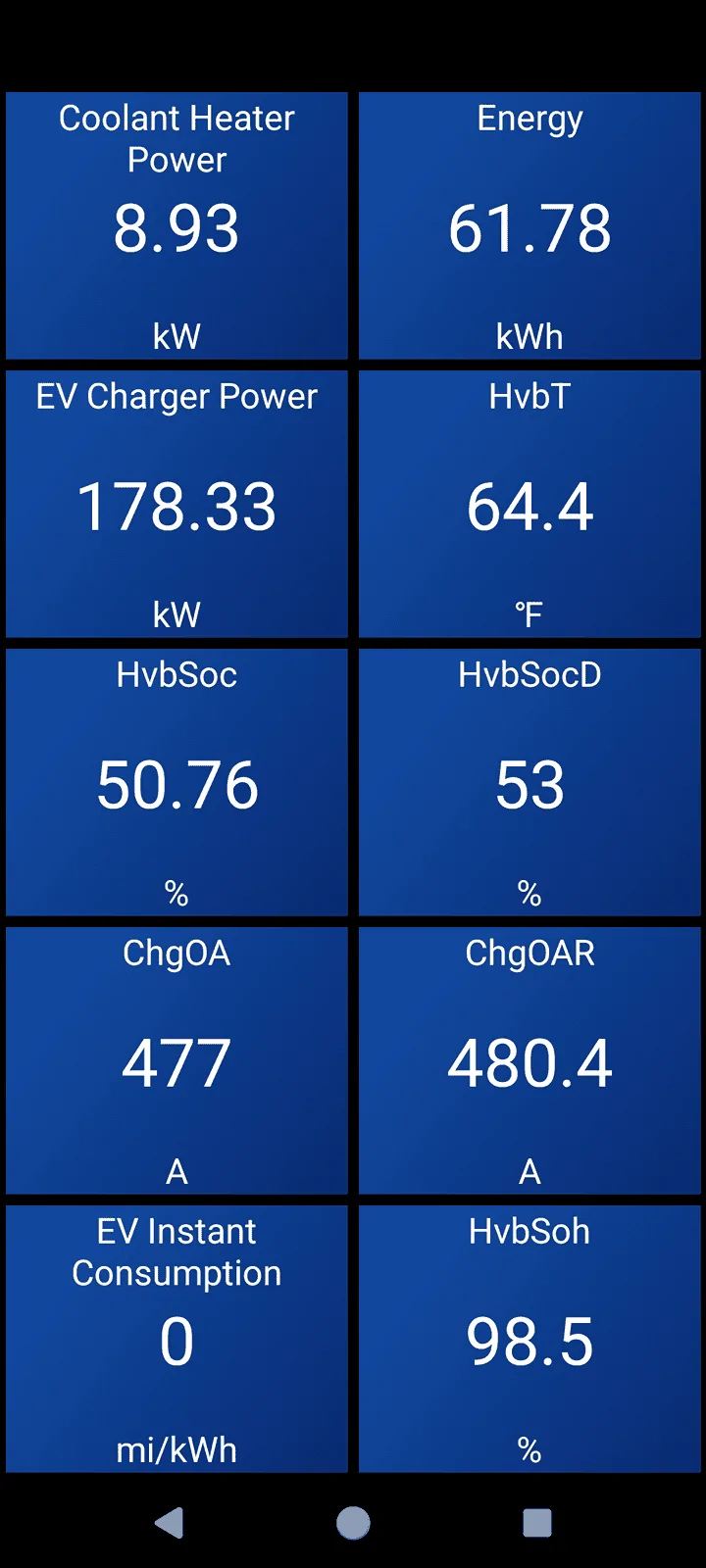

I also wish the boost period can stay longer, especially in winter
continuous of 450Amp charging until 70% would be a dream from low SoC
