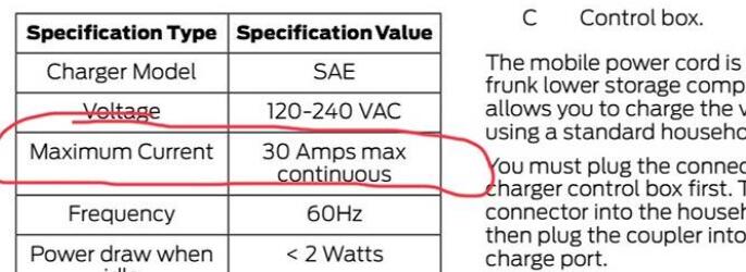

So If i change my breaker to a 60 amp (currently a 30amp) will that increase my charging ability with the supplied ford charger? would that be safe? its a 23 XLT
Danger Danger Danger!!!!!
You should not be using the Ford Mobile "charger" on a circuit that is rated for 30 amps.
1- A 30 amp constant load device requires at least a 40 amp circuit (1.25 x the device amperage or 80% of the circuit rating) . A 30 amp circuit can only legally handle a MAX OF 24 amps. That 40 amp circuit can legally handle a MAX OF 32 amps
2- You simply cannot replace a 30 amp breaker with a 60 amp breaker to increase the capacity of a circuit. You must also have the proper wire gauge to support 60 amps.
3- FINNALY- THE FORD MOBILE "CHARGER" PROVIDED WITH A LIGHTNING IS FIXED AT 30 AMPS NO MATTER WHAT CIRCUIT IT IS CONNECTED TO !!!

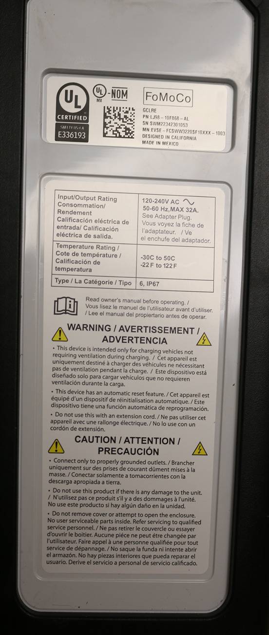

I just had a 50 amp RV hookup installed at my house. I plugged in my Ford charging cable and it reached a maximum of 6.6 kw/hour. Is that the fastest one can charge with the standard Ford charging cable? Thanks.
The Ford Mobile Power Cord says (on the back of mine anyway - see image) 32A max, so at 240V that's 7.6kW assuming no losses.
But perhaps they operate at 30A as some contend, then 7.2kW max with some losses at 240V.
So your output seems lower than would be expected IF you have a 240V circuit.
But is you outlet voltage 240V?
If it is say 220V, then that's why you get 6.6kW: 220V x 30A = 6,600kW
Regardless...the FMPCs have a spotted record based on posts about failures after relying on one exclusively for charging for some period of time (months).
On a 50A 240V outlet you could charge at 40A (80% rule and NEC code for plug-in EVSEs).
So find a better EVSE suitable for daily use that can charge at 40A. Or higher if hardwired on an appropriately wired and protected (breaker) circuit.

I expect Webasto downrated the chargers internally but didn't change the labels. Mine looks exactly the same on the back.
You can test your charger a few ways:
  1. Use it to charge your Lighting. See what the charge rate is on the FordPass app.
  2. Use an ammeter to measure the output. You will find a square 30A draw during charging.
  3. Plug it into the ProPower Onboard of your truck and charge an EV (or charge your own truck) using the 30A 240 outlet. This requires an adapter to go from the 30A outlet to your NEMA 14-50 on the charger. If you have a 32A charger, it will quickly pop the circuit. If you have a 30A charger it will work just fine. I gave a Fiat 500e half a charge this way at an EV display event Saturday.

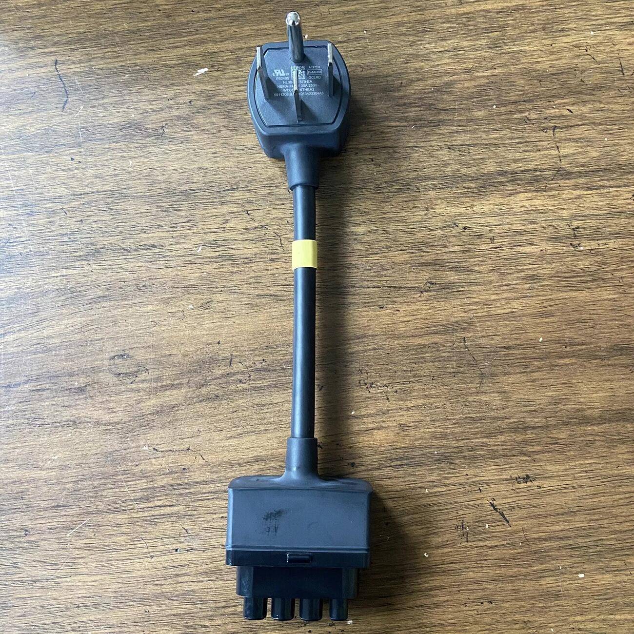

@chl
Chris,
Mach-E and Lightning Mobile EVSEs are the same except for the pigtail.
If the pigtail for your mobile Ford OEM EVSE has a piece of yellow tape on it, then it is limited to amps. If no tape then it is the 32 amp version.
The Lightning's ProPower 240vac output can handle 30 amps continuous , unlike a typical home dryer outlet which is code limited to 80% of circuit rating for continuous use.
Tesla has multiple cords that will change the output of their mobile connectors. I have a 14-30P plug version for my Tesla Mobile Connector that plugs into my 4-wire 30 amp dryer outlet and limits the Tesla Mobile ESVE output to 24 amps.
Here is a picture of a 30 amp Lightning pigtail.

To add to this.
The Ford mobile charger is a rebranded Webasto Go, which other OEMs use as well. In other areas you can change the pigtail of the unit to tailer the output for a specific plug and current.
Folks on the Mach-E forum tried the TT30 end for the Cadillac charger but found it didn't work on the Ford mobile charger.
