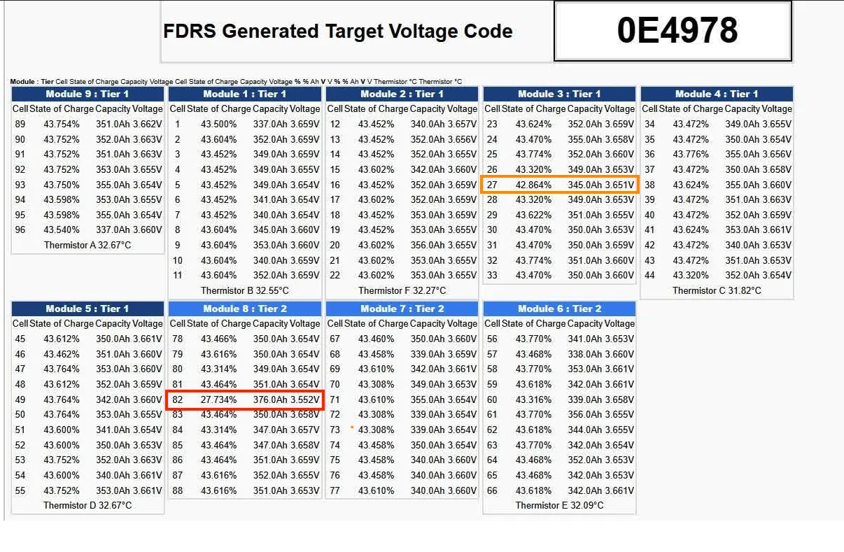

Ended up having a bad cell. Fell under SSM 53208, array 8 replaced under HVB warranty.
Truck has been at the dealership for a couple weeks now but I was able to determine it was done because they started charging it. Communication hasn't been the best...
The bad cell was 82 in module 8, there was no warning for the failure. Also noticed that cell 27 looks kind of different to the others.
Ford F-150 Lightning Home Charging STOPS at 85% 1784319318252-di
Cell 27 is about 3x further from the pack average than any other healthy cell (-0.68% vs -0.24%), and it sits 0.44% below its nearest neighbor when every other cell is within ~0.13%. It's within the 0.030 V flag threshold, so FDRS didn't tag it, but it's the next cell down the same list as the failed 82.
Not sure if this means anything or if it will all balance out nicely, but worried that could be something to keep any eye on.
