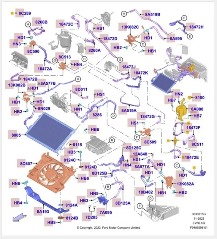

Is there a place where one can find the "work shop" manual? To me, so far, any material, Ford has, on the truck appears to be closely held. So far, unable to get any tech advice from a Ford service at a dealership. Be good to know what the PTC heater even looks like, I do see where to lock out the HV with the safety wire. Or a diagram to figure out the flow. I see online a copy of the Mach E diagram.
Not sure if this will be nay help, but this is supposed to be the heating/cooling system components - you'll have to look up what's what on a parts web site I guess.
Ford F-150 Lightning Red Brick at home 2023 Ford Lighting heating system

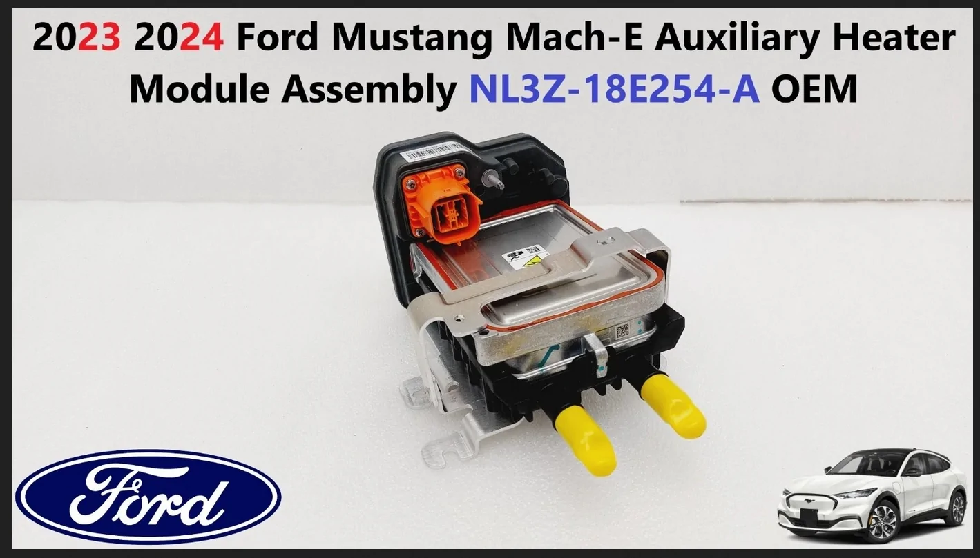

PS: it might be the same as this Mach-e part?
Ford F-150 Lightning Red Brick at home 2023 Ford Lighting NL3Z-18E254-A  OEM
chriserx
Oct 3, 2025
767
590
Louisiana
I suspect it is, I wonder how many parts are shared. Be nice to know what the hard to source parts will be with the cancellation.
