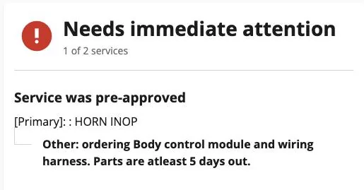

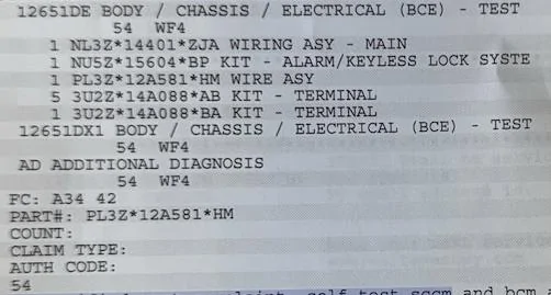

After 101 days, this saga has concluded.
Ford F-150 Lightning Horn stopped working randomly 1753730007342-n2
15728 verified cust complaint. self test sccm and bcm and both passed. elect diag. found corrosion on conn 2280f with no power out to horn relay. found corrosion on conn 2280a. partially removed under hood wiring harness and replaced both conn 2280f, conn 2280a and replaced bcm. performed pmi to bcm. retest all and verified repair. all repairs per tech assist case #redacted
