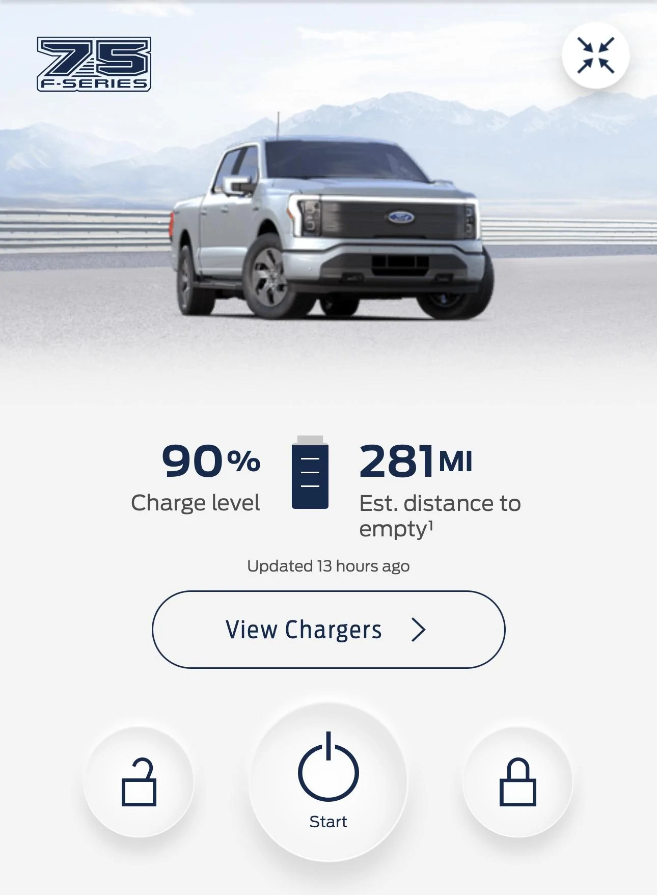

New Ford Pass Update for IPhone 4.24.0, it comes with 75th F150 Logo, hopefully that helps.
Yeah noticed that. Mine started working again after about a week of being down. Now if only I can get an update pushed to the truck
