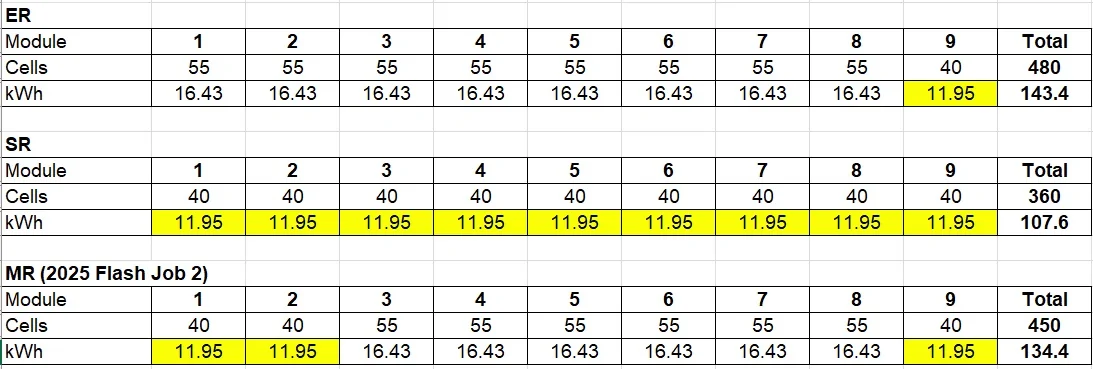

I read somewhere that the SR and Flash have one 11.3kW(?) charger, while the ER has two 9.6kW chargers (for a total of 19.2kw).

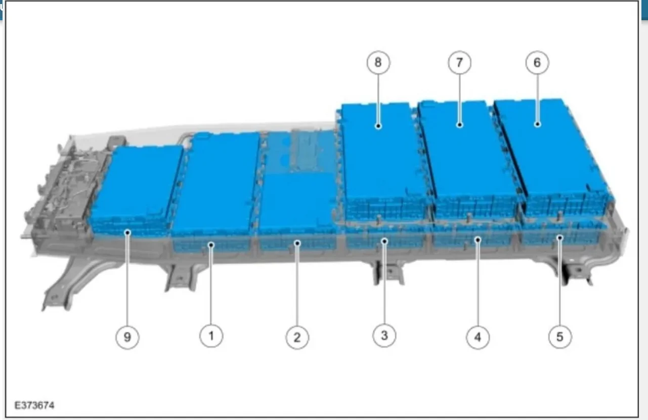

All Lightnings have 9 battery modules and the 9 modules all take up the same physical space in the truck.
The configuration chart for the respective batteries:
Ford F-150 Lightning How do the dual OBCs work? ER-SR and Flash battery configurations
They are laid out like this:
Ford F-150 Lightning How do the dual OBCs work? 9 battery modules
