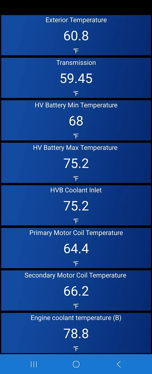

Has Your battery been spending a lot of time at SOCs near zero or hundred? Or has it had many hot days? They really don’t like heat. I just came back from a trip. DCFC took the battery temp from 82F to 106F. I drive in Sport mode right after DCFC charging, it seems like it cools down the battery faster (lower threshold for cooling system to kick in). I also try to park it in the shade anytime I have the option.

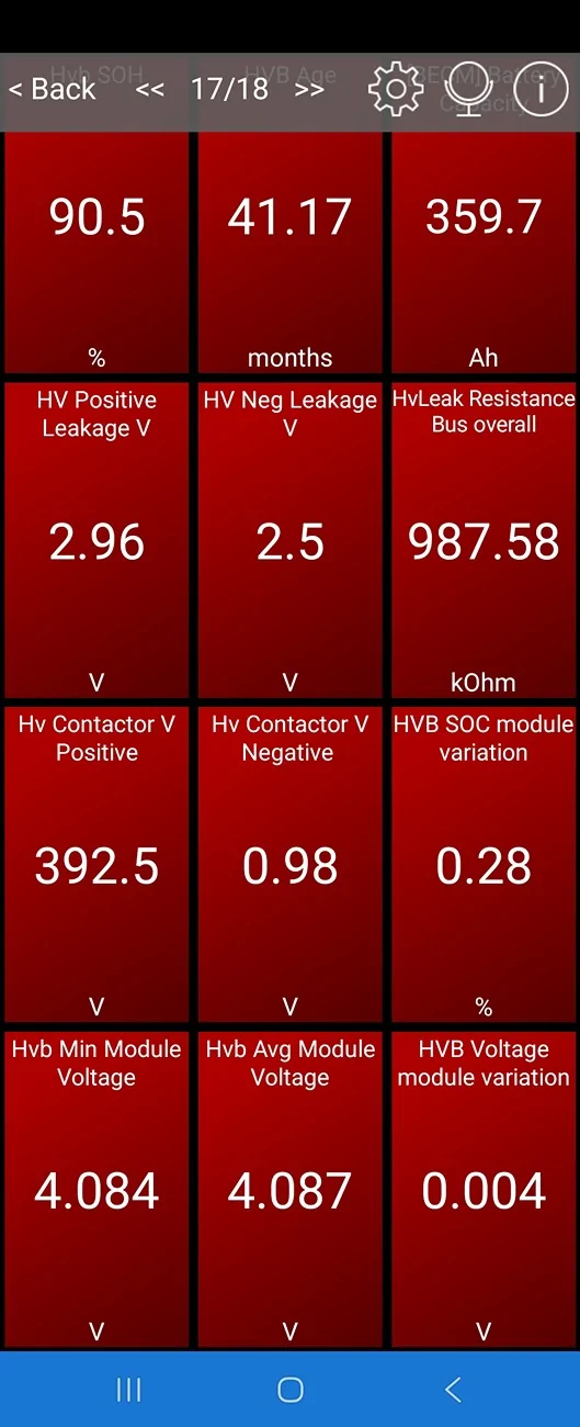

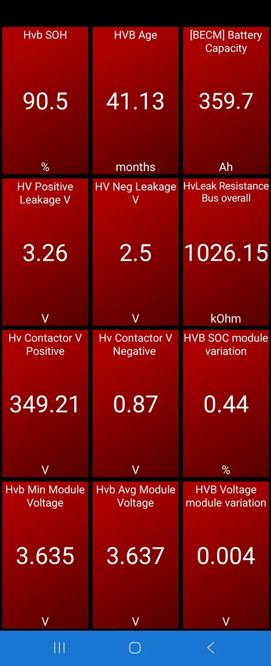

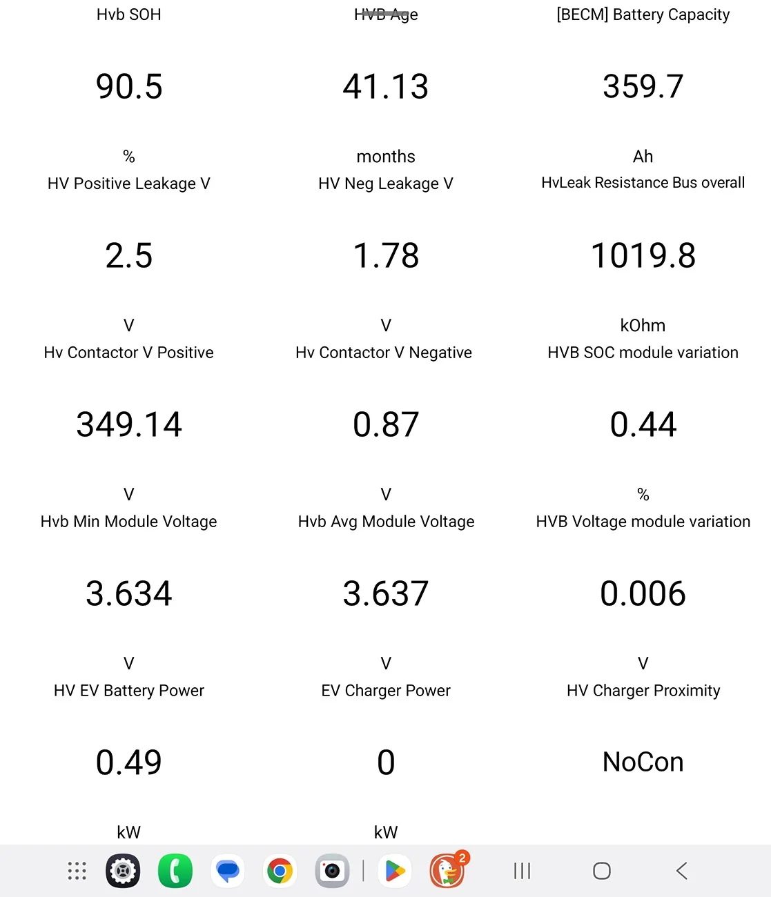

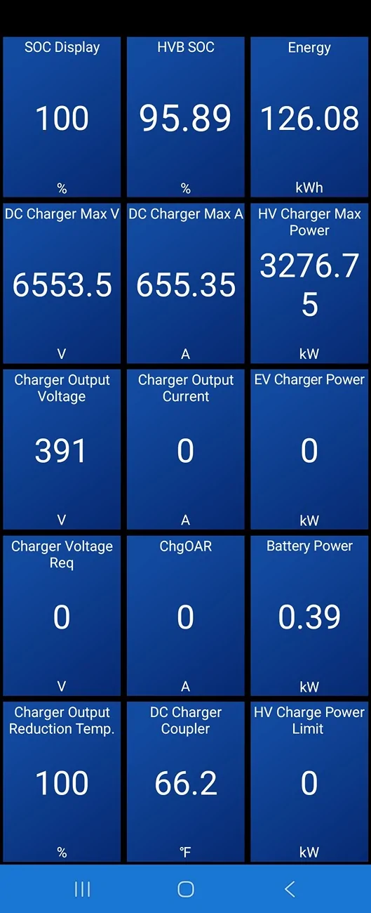

I never get close to zero SOC. Seldom to 100% soc and never sets that way for more than a day. Max temperatures don't look bad at all. After charging from 36% to 100% at 17 kwh my SOH still showing 90.5%. 131 kwh battery only showing 126.08 kwh of energy.I guess I'll try taking it down to near zero and charge to 100%.
126 KWh of energy supports that SOH is real. The only thing I can think of to cause it not be real is that if you captured it immediately after displayed SOC hit 100% and didn’t wait until it is fully charged. My battery (standard pack), takes near 1 KWh per % for most of charging but many more KWhs from 99%-100% and more after.
Your module variation looks good so there may be other reasons your batteries internal resistance has gone up. If you get 126 KWh out of it, and your long trips are 120 miles round trip, just enjoy it knowing you still have many years left on that battery warranty. I have never felt like I needed more than 98 KWh. On my recent trip, I was fast charging between 20/30% to 80% and that gave me 120 miles of driving between 1/2 hr stops. The length of stops and drives were perfect for us.
I know the number may look disturbing comparing to everyone else. Frankly I didn’t like my 98% when others where reading 100% but if the truck is driving fine, don’t let numbers take away from your enjoyment.
