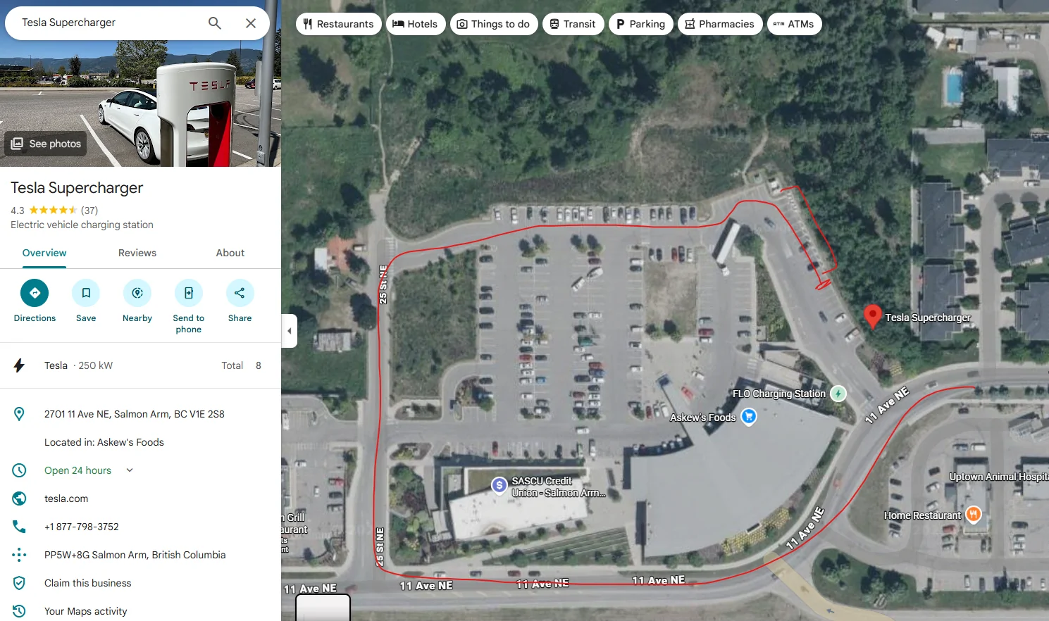

Yea the street view/google maps helped, and then in Google when you click the icon for Tesla Supercharger, or whatever brand of charger it is, often people have posted pics of the site...those are typically the most up to date (i.e. for new locations that aren't yet showing up in satellite or streetview imagery)
So in the image here, I knew that if I looped around the whole parking lot like I did, that I could pull in with the left charging door where I wanted it to be, and I could charge without unhooking. You can see the pics people post in the upper corner, helps a lot. Especially for Tesla sites, Tesla drivers love to take pics of the locations, which is quite helpful.
I also then knew that I had lots of room in the parking lot to maneuver if i needed to drop the trailer, but luckily for us on this trip, that didn't really happen often.
*EDIT* Final piece of advice, truck and trailer takes up 5 standard parking stalls (8' wide x 5 = 40'). So if you are pulling up on a row of say 8-12 tesla chargers, you can plan your parking accordingly so you leave a few stalls still open.
And like others say, stay with the vehicle when you're blocking chargers like this so that you can move quickly if you need to.
