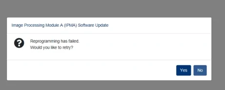

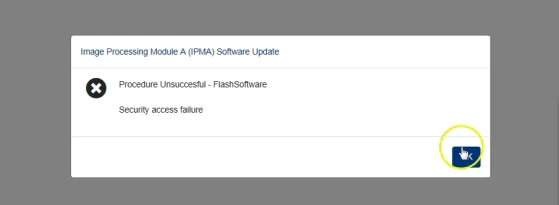

I tried to update he IMPA and I can't get it started I got a these messages both times I tried. "Reprogramming Failed" (Click "no" the second time) and then got the "Security access failure". Thoughts?

Not sure about IPMA.I have flashed it without any issues. It just takes forever. About 3 hours or so.
