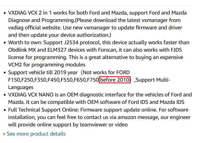

@Jesse-Infotainment interested to see if that device really does work on the '21s... the amazon description literally says "except F150".
It says "does not work for FORD F-xxx vehicles BEFORE 2010".

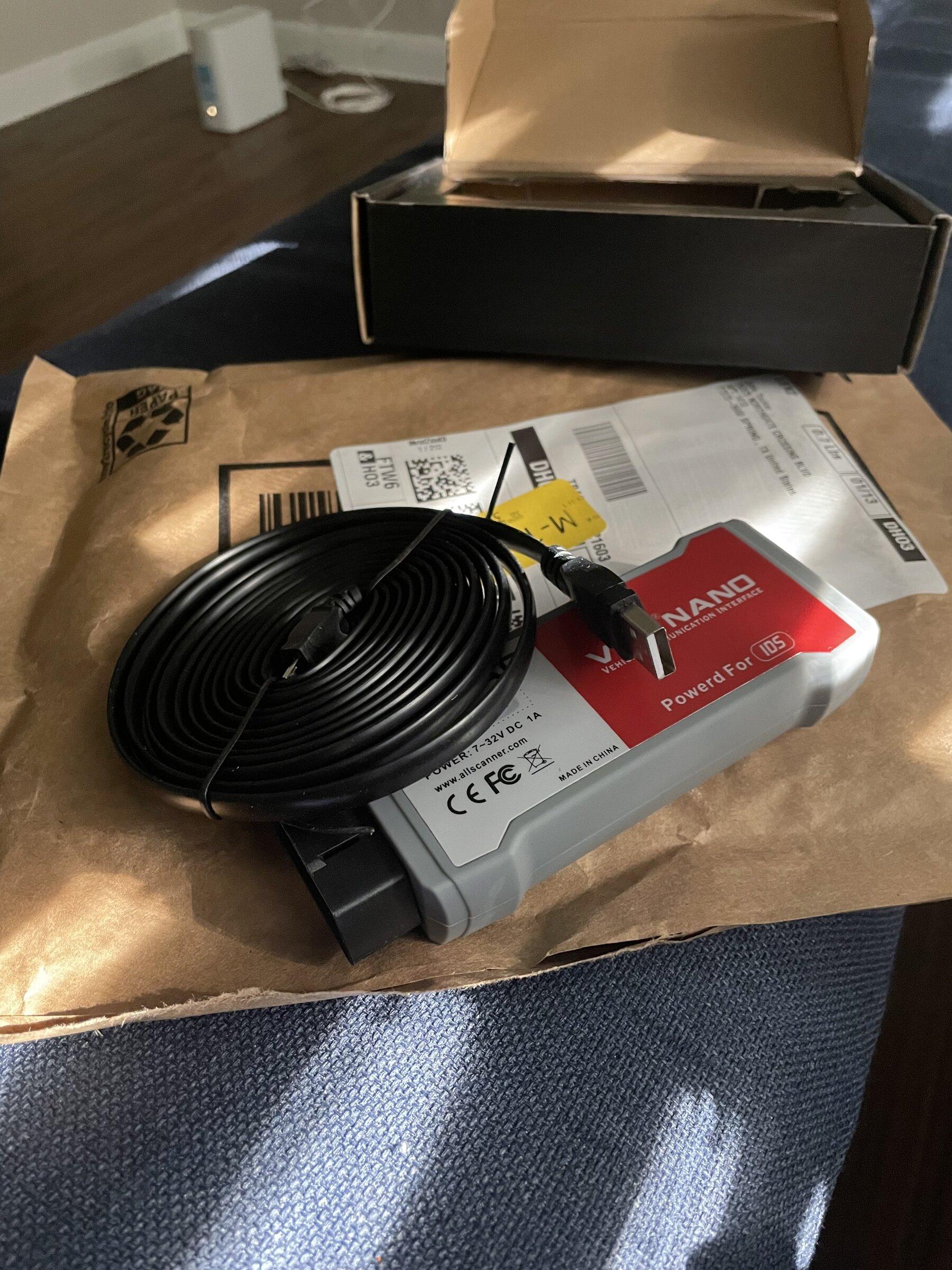

Btw, the guy Jesse refers to is me. I bought this device about a week ago, and I used it with Fords FDRS tool and 2-day non-dealer license that you can purchase here. You can download FDRS software here.
For the tool itself, you will need to install the VX Manager that can be downloaded from here. Once you install it MAKE SURE you set it up as J2534 pass-through device, not as Fords VCMII! After that FDRS tool will recognize it just fine.
I have flashed all my modules with this set up, including the IPMA module that took about 3 hours to complete.
This device works, just need to really pay attention how you set it up.
NOTE: I would not install any software Amazon sends you with the tool (I did not get any), people reported having issues as well as AV flagging the software suspicious.

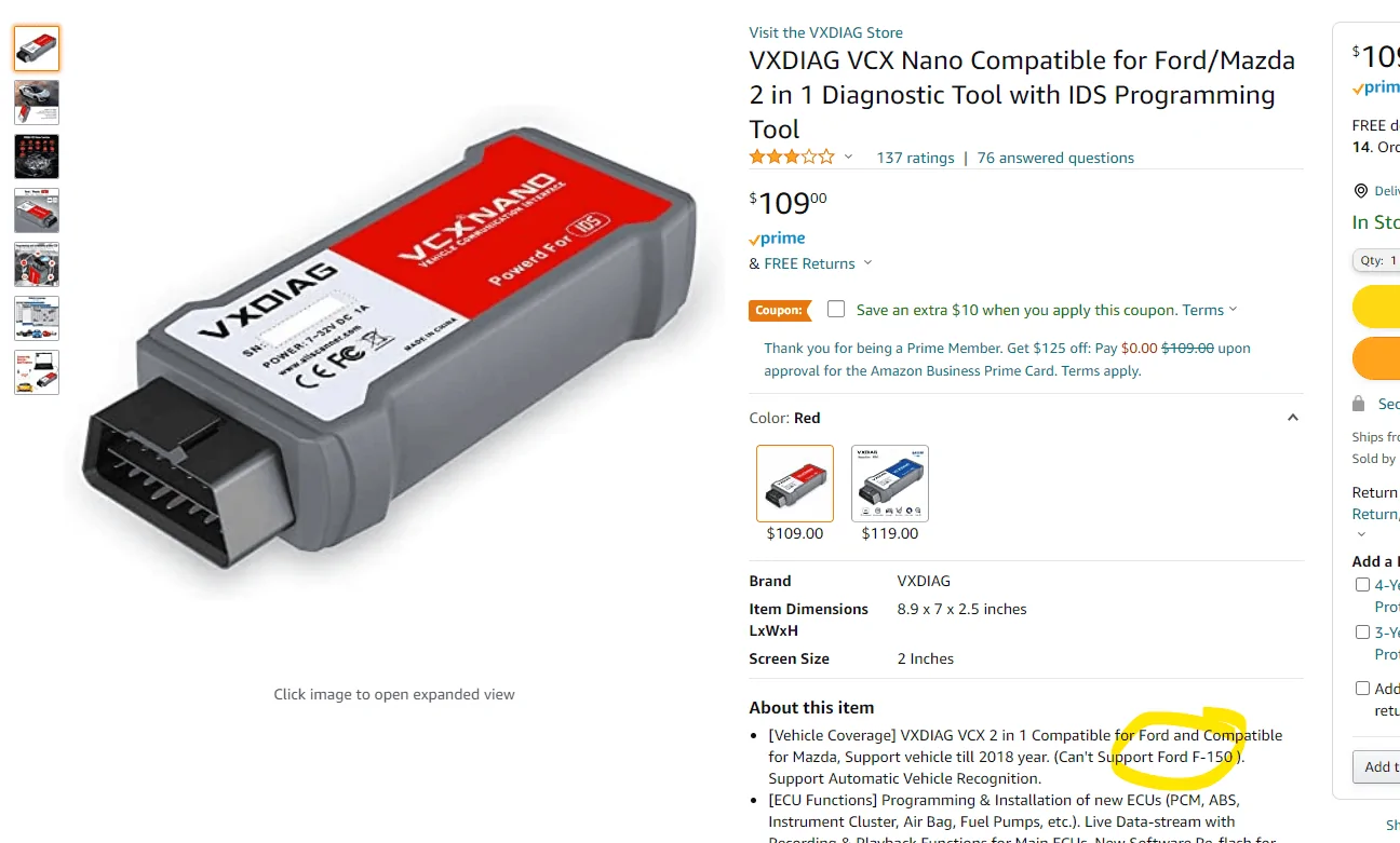

Hey! Awesome. There were two listings; one was this (I highlighted the scary part):
Ford F-150 Lightning How to find latest version of OTA SYNC4 Updates? Screenshot 2022-01-12 112136
So I bought the other listing instead :)

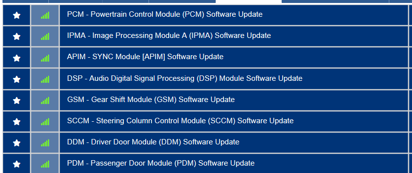

General question in regards to FDRS updates.
I see that I have updates on many modules. Do I need to do them in a particular order?

I did not. Just keep in mind IPMA takes the longest. Up to 3 hours! I would do it the latest. Also, if you update DDM and PDM, you will need to reinitialize the windows open/close logic.

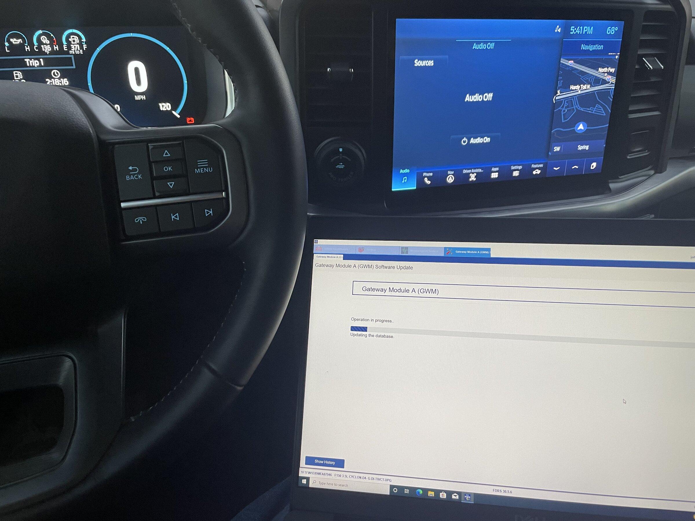

@Jesse-Infotainment @iceman77 It worked perfectly. This is something someone should genuinely do a write-up on.
That being said there's always one thing: the app developers were smart enough to know that I was using a VirtualBox VM (which to be honest could be easily cloned and added to other PCs). I wasn't even mad; I was impressed. That being said a normal install of W10 and just the driver package for the nano got me where I needed to be.

Can you perform the updates with the vehicle running versus just ignition on?
Agreed there. If someone wrote this process up, it would be greatly appreciated.
johnatuckeriii
May 16, 2021
63
Houston
2021 F-150 FX4 SuperCrew AMB
The modules I updated today were all Key On; Engine Off. FDRS tells you how to manage the battery (including telling to to attach to a battery tender).[/QUOTE]
