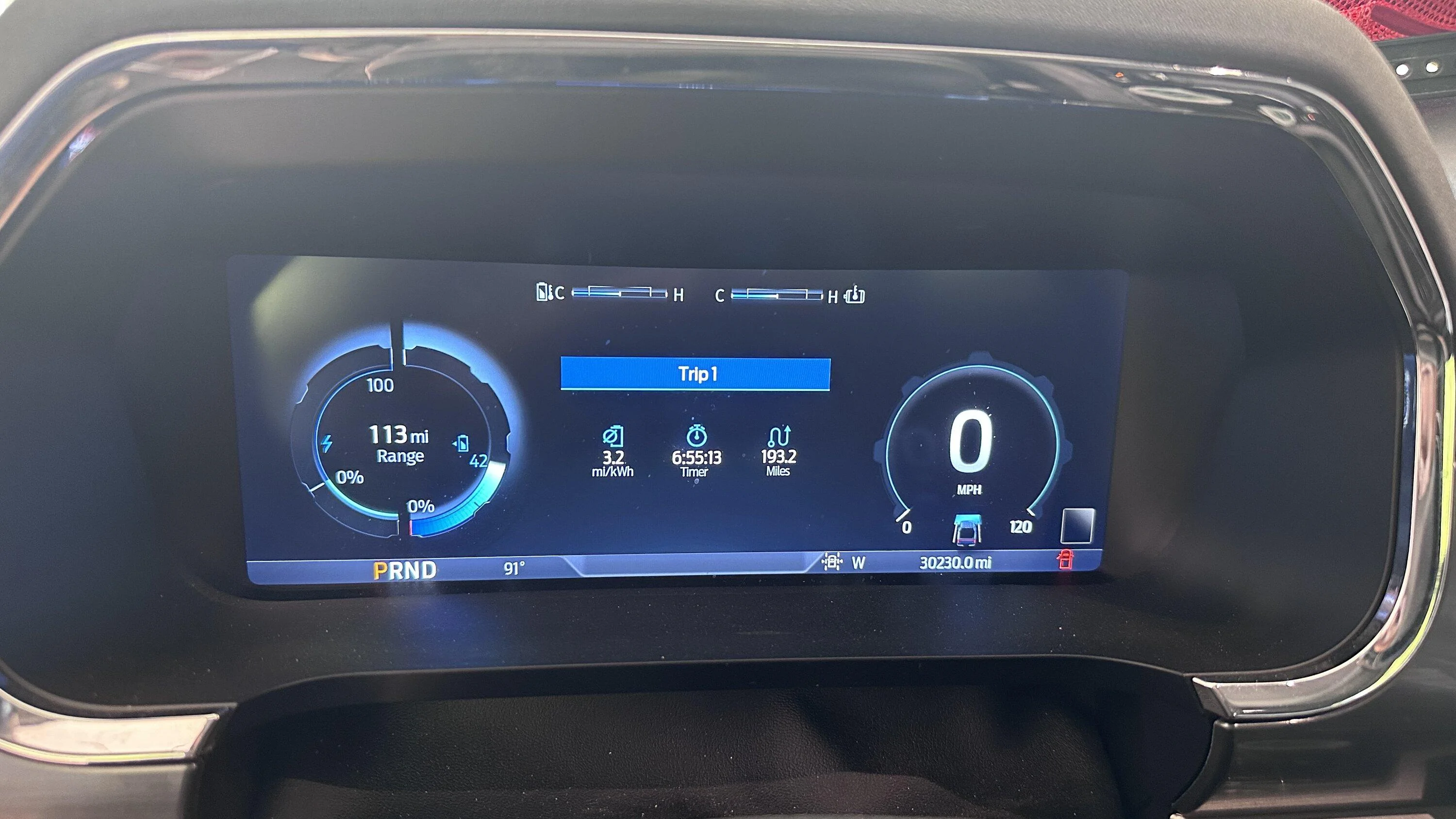

here's a hypothetical back to ya:
193 + 113 = ?
Ford F-150 Lightning Hypothetical Trip Info 193 + 113 = 306
306 miles of range, on a single charge... PRO standard range battery. over 30,000 miles now, too.
240
16,853
19,179
At 27. mph he got that, assuming the entire 6:55:13 timer is in motion, you plan on some highway speeds at or above 60+......
Stick with Rick's projections, I also think you will be good, but definitely have a back up plan and have fun.
no, not 27 mph, but a lot of the truck being 'on', but not moving... the average was more between 45-50, with no wind, some stop-n-go, etc.
I just posted this to prove a point - you 'can' go much, much farther - but, SPEED, and other factors, are not your friend. Slowing down will always get you 'farther'... although most folks don't want to go that route.
