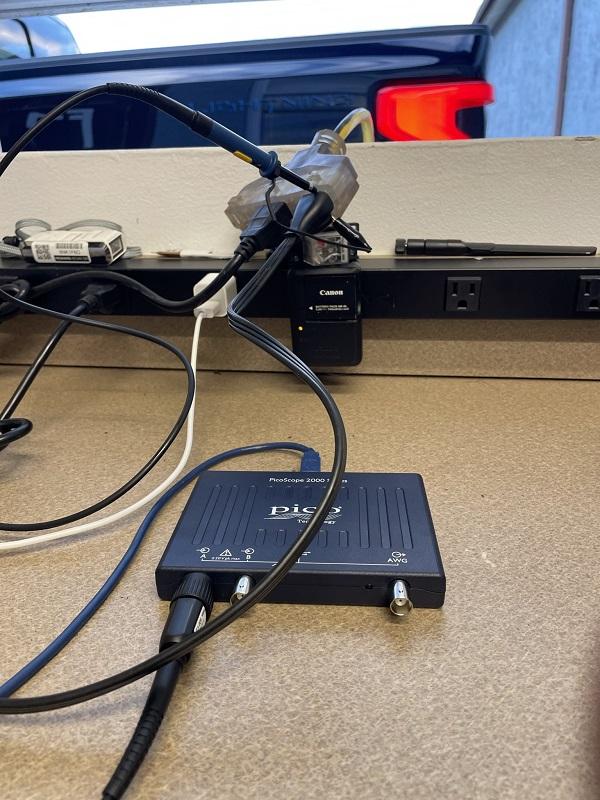

The power went out at my shop this afternoon in the middle of a project, so rather than fire up a gas genny, I used Pro Power, which worked great. Curiosity got the best of me, so I hooked up an oscilloscope to see if the inverter was pure sine wave or modified sine wave, and then tested utility power (JCP&L) which came back on.
The Test:
Ford F-150 Lightning I Confirmed ProPower is a Pure Sine Wave Inverter - And the Power is CLEAN! IMG_7991

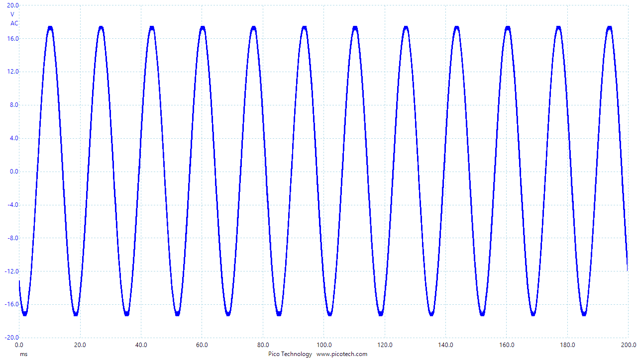

Truck Power:
Ford F-150 Lightning I Confirmed ProPower is a Pure Sine Wave Inverter - And the Power is CLEAN! F150Lightning20221019-0001_01

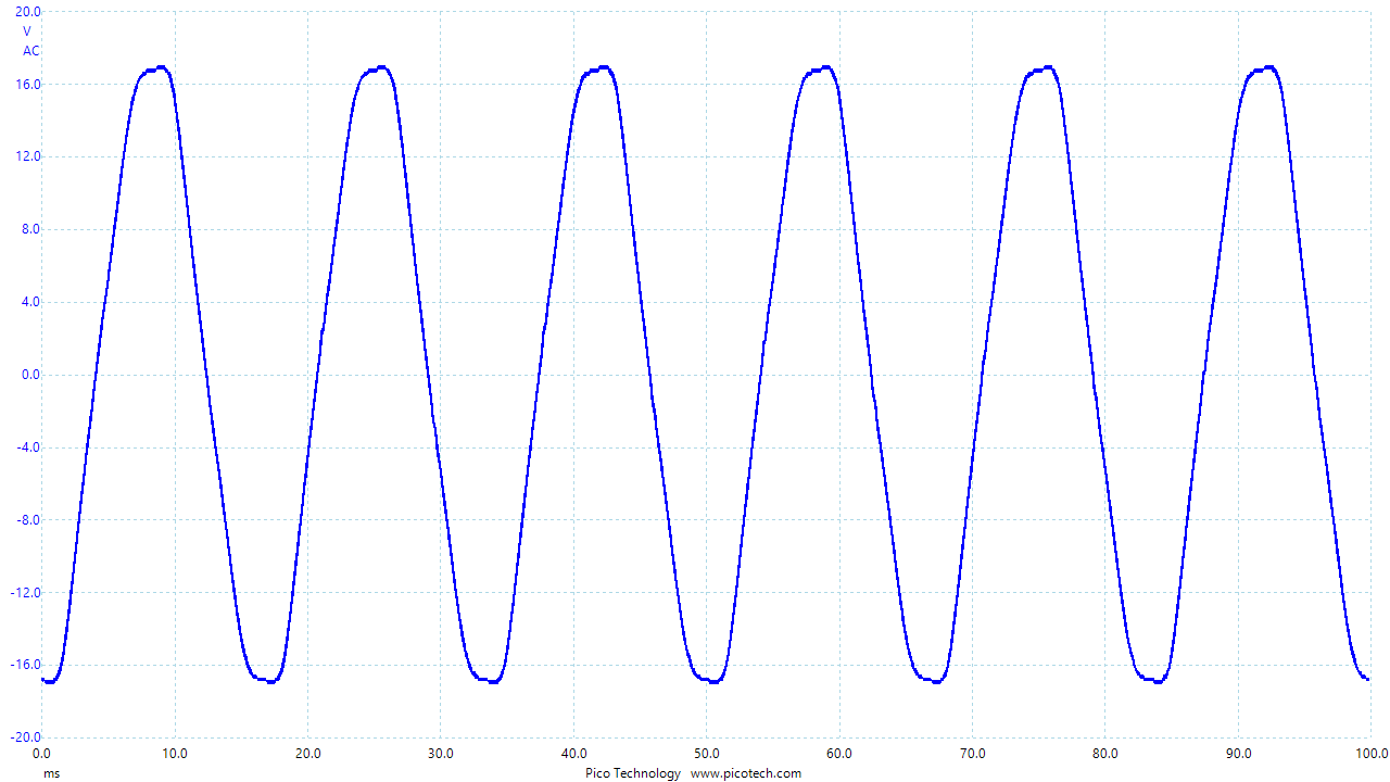

Utility Power:
Ford F-150 Lightning I Confirmed ProPower is a Pure Sine Wave Inverter - And the Power is CLEAN! WallVoltage20221019-0001_01
The graphs are slightly different time scales (sorry!) which is why the waveforms look a bit different, but the power coming from the truck is CLEAN! Thanks Ford - nice job!

This was just the bed outlet, with almost no load.

I was expecting a high frequency stepped sine wave but this looks so much cleaner!
No worries running a PC desktop off it!

It is hard to tell for sure just how clean the bed output is from your image of the output.
Some modified sine waves are "cleaner" than others but not pure sinusoidal, and just dirty enough to cause sensitive equipment to malfunction.
Some other posts have noted a difference in the output from the front inverter and the bed inverter in trucks with two inverters (9.6kW ProPower) and found that the bed outlets cause malfunctions in things sensitive to "dirty" power (modified sinusoidal), like electric blankets.
Does your truck have the 9.6kW ProPower which uses 2 inverters?

When I took delivery on my Lightning I checked the bed outlet waveform with an oscilloscope. My calibrated eye rated the THD at less than one percent.

Yes - Mine is a 22 Lariat with the dual inverters.
