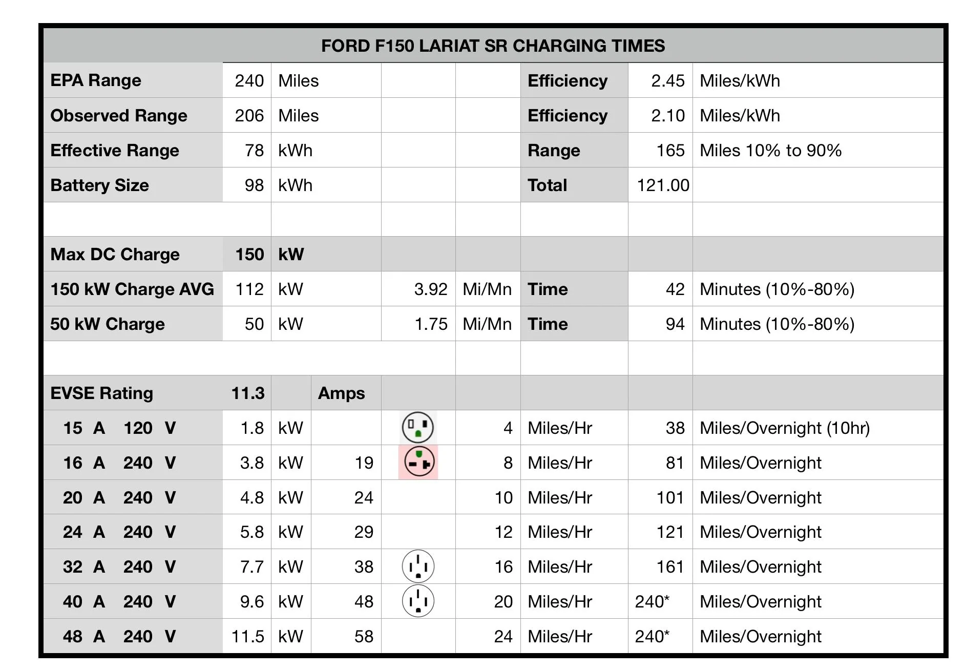

This chart gives you a *rough* idea of the potential charging times based on a naive assumption that all of the kW in the charger makes it into the truck. The Ford has a fairly flat charging curve (takes the same amount throughout the charge session) until it gets to 80%. It takes significantly longer to get to that last 100%, but unfortunately I have not come across any charts that show *AC* charging speeds at various amperages, so this is what I go by. If anyone has better data, I'm all ears.
This is for the 2023 Standard Range Lariat:

I should add that on my most recent long trip I was getting between 2.3 and 2.5 mi/kWh so the range on my chart is low. In reality we could drive about 160 miles comfortably while keeping to our rule of not fast charging above 83% or going below 10%.
