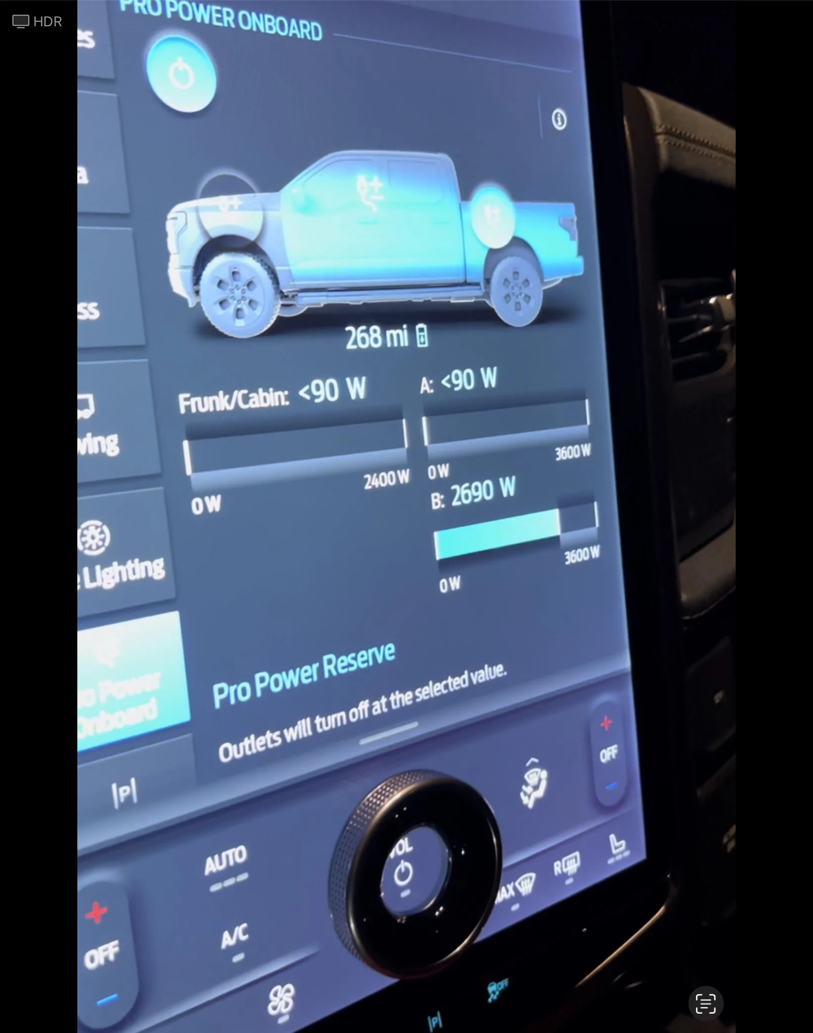

Before going to two cords, this is what they were drawing
Ford F-150 Lightning Ice Storm Power Outage — Pro Power Onboard to the Rescue! ACE0DB85-FB7F-4932-AF52-9E36D5844EE3

So the truck allowed you to draw 2690W on a single 15amp extension cord before you smartly switched to 2 cords am I understanding this correctly?

The pic is showing one extension cord with power strip on the end, yes. The draw you see was 3 small space heaters and some LED light strands. I eventually went to two extension cords out of necessity rather than intellect, as you suggested.
