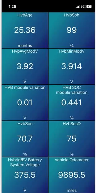

12V SOC and HVB SOH are the two main uses for me. Also add in the HVB module variation (I had a battery module/array failure in May). For me, it is a check when needed thing and not continuous.
Also handy to see any DTC's that you may have, especially when you get a power train message. It will also do your 0-60 times if you're so inclined.
EDIT: Here is a screenshot I save every month to track battery health:

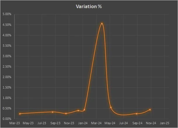

Does anyone know at what HVB module variation will the truck throw a reduced power pop up?
2,644
3,741
I know 4.50% will!
Here is my Variation% history showing module fail last March.

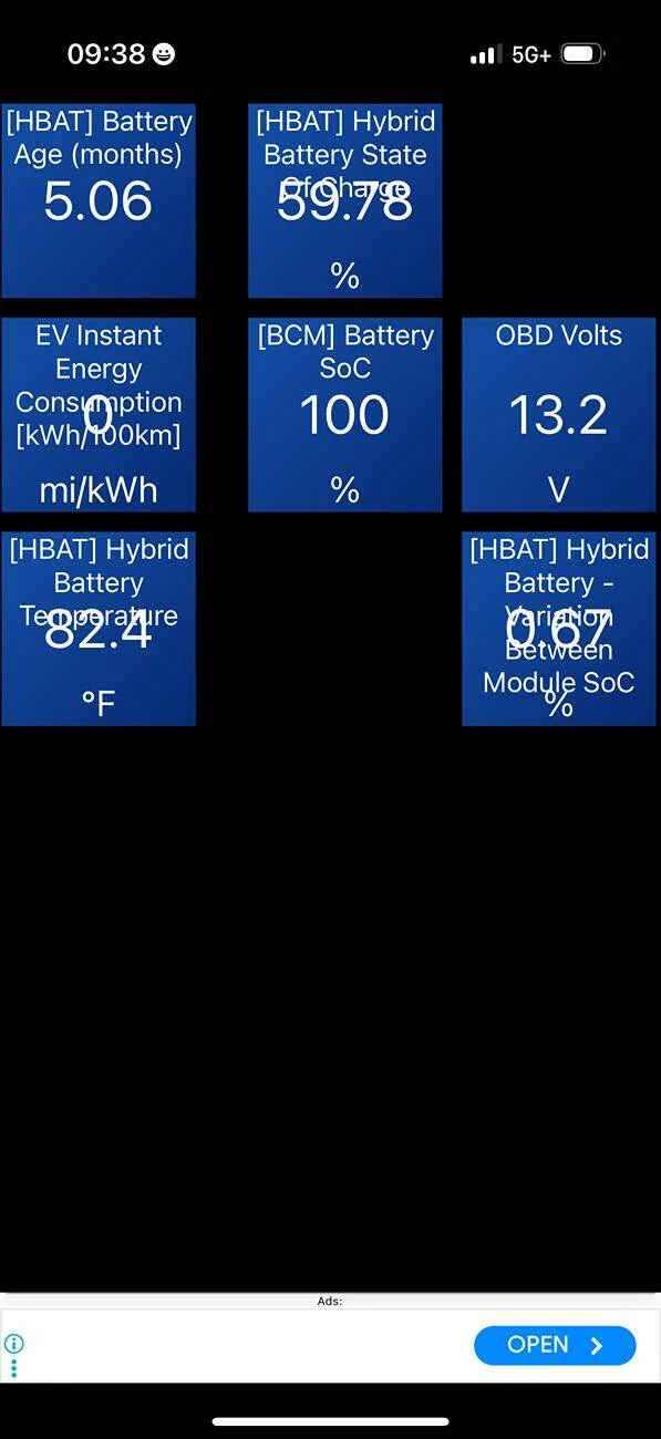

Thanks everyone. Here is my first dashboard attempt using the ideas here.
Just starting to setup mine to yours but can’t seem to pinpoint which modules(?) to search for. Do you mind sharing what modules(?) and size(i have at 120x120 on my pic)setting you used on yours please.thanks in advance.
P.s. i think you customized your labels but do i have to have the car scanner pro version to find the modules on your dashboard? Im still on the free version.
