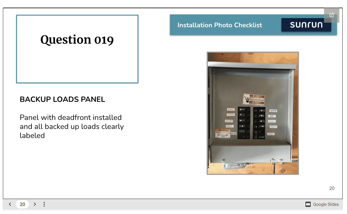

Also, the required photo checklist for installation commissioning shows a panel with at most 12 breaker slots: https://sites.google.com/sunrun.com/sop/photo-checklists/ev-charger-system-checklists?authuser=0 (sign in with a Google account; see slide 20 in 2nd set of slides for EV Charger and HIS by clicking on slide number in the lower left of 1st slide)
