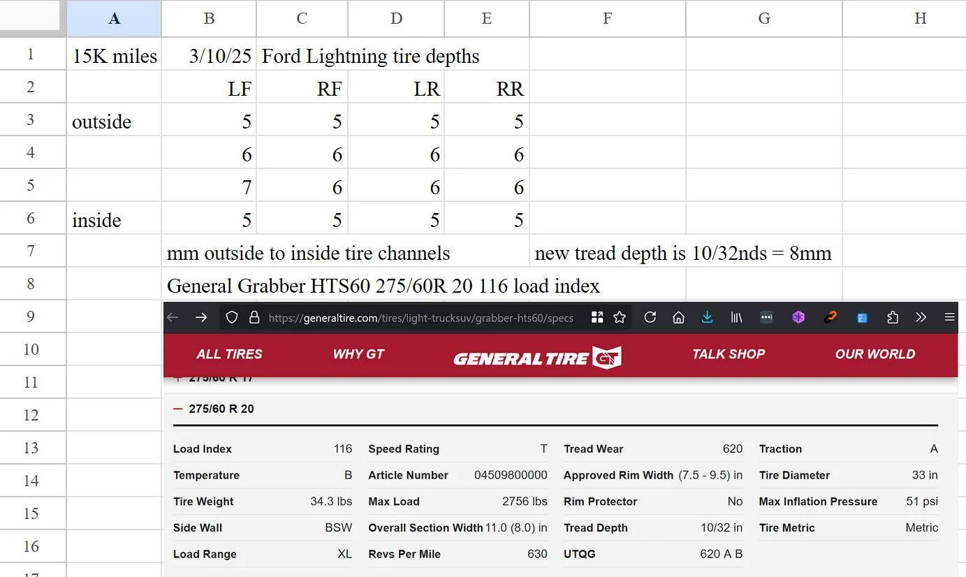

I have 15K miles on the General Grabbers, 275/60 R20 116 load index. The wear pattern looks the same for all four tires. Also, it looks like I have been underinflating the tires at 42psi as the outer and inner channels (of the 4) show more wear than the center 2 channels. Any burning reason to rotate tires if all are showing similar wear patterns? BTW, I raised the inflation pressure to 45psi in an attempt to get the wear to occur towards the tire centers.

With the truck almost having a 50/50 weight distribution, I was wondering the same. I guess it really depends on if you tow often or usually have things in the bed of the truck.
I believe the answer on this is clear and unequivocal.
The answer is, it depends. It's entirely dependent on the vehicle. On most vehicles, it's necessary to rotate on some type of schedule (which can vary wildly) to keep tire wear even.
However, there are plenty of vehicles out there that have no need, and no benefit, the tread wears evenly, with no unusual tread or wear patterns.
