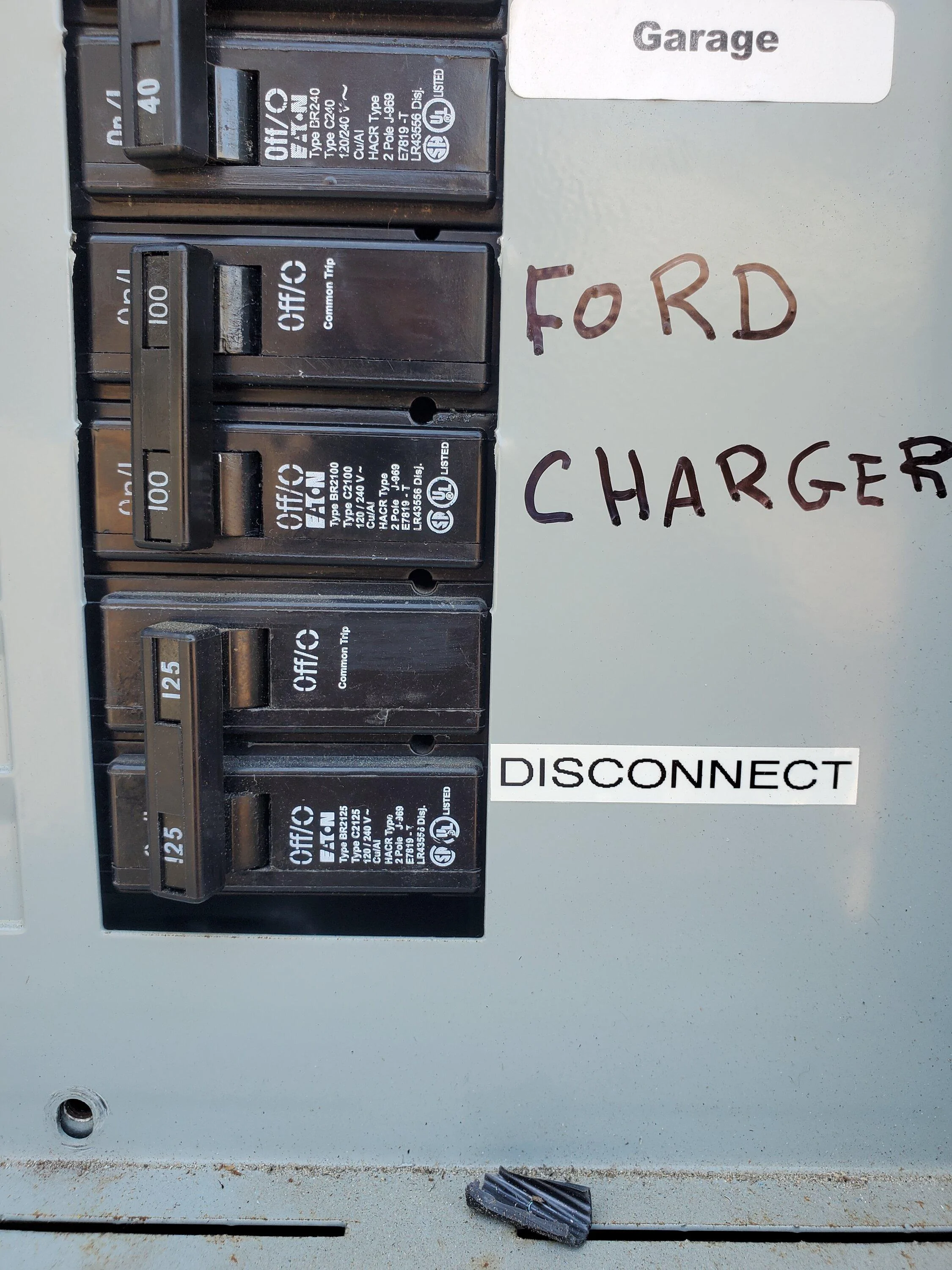

Since nobody else has asked, by any chance is the 100A breaker in your panel a GFCI?
I don't see anything that specifically says so or not. Here is a picture.
Ford F-150 Lightning Issues with Charge Station Pro 20220803_133209
4,202
5,571
The last time I checked, no one made a 100A GFCI breaker for residential load centers. I’ve only seen 3 phase and bolt-on in 100A size. Some one may be making them now given how rapidly the NEC is expanding requirements for their use.
