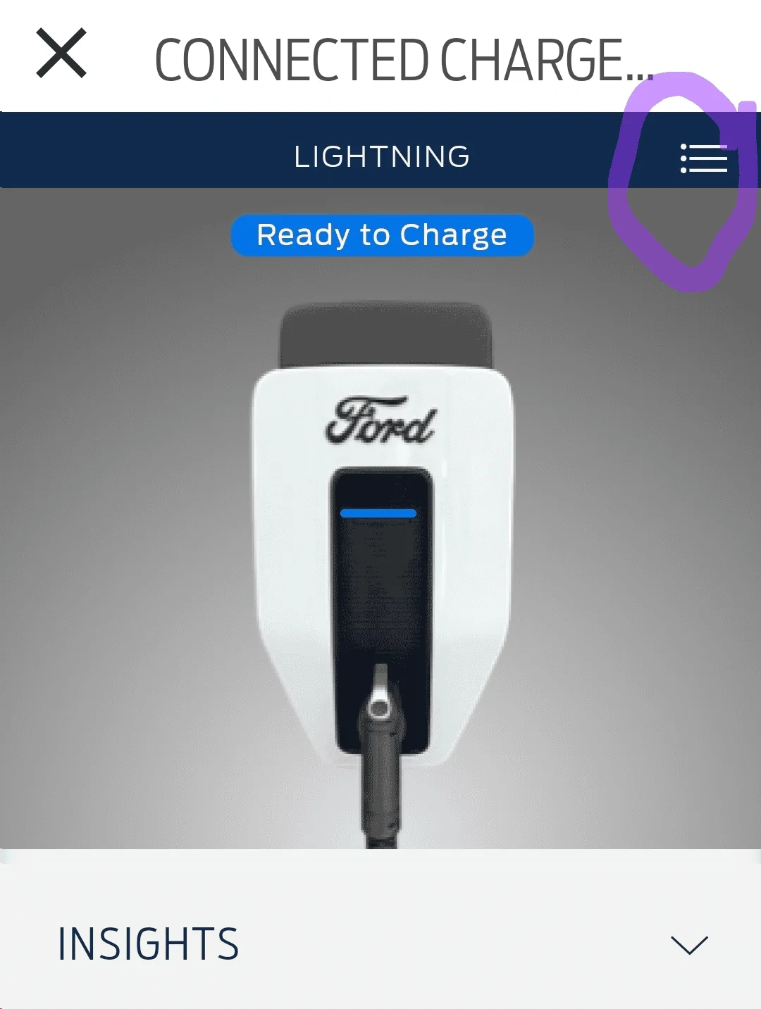

Several seconds later, click the 3-bar in the upper right corner

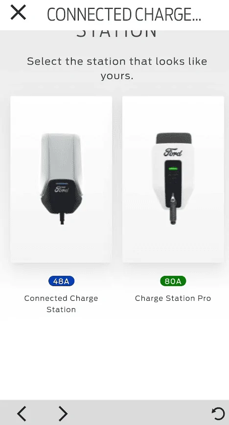

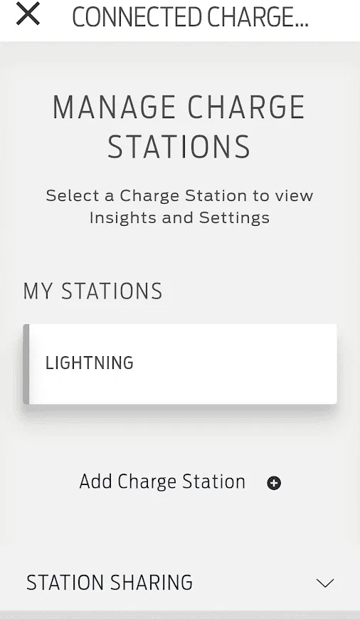

Click Add a charge station
Ford F-150 Lightning PRO STATION ISSUES 1707328111015
Select the CSP on the right [FCSP] then ...... click Connect to Fordpass manually

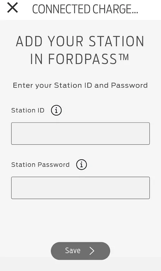

Input your station ID and password, click save, you "should" associate your FP account to the charging station cloud account, note you may not see data on this station until you have successfully completed a charging session and then unplugged from the truck.

Thank you @TaxmanHog I appreciate the help. I did not see the connect manually before. I just tried it but it did not see the CSP. I'm going to try the factory reset and then do it that way. When you do the factory reset, the power needs to be on, right? I'm just concerned about having the power to the CSP with the front panel off and wires exposed.

OK @TaxmanHog I did a factory reset and was able to get the station connected to my wifi. When I go to add the station with the exact station ID and password I am getting a "chargepoint not found" notification.
