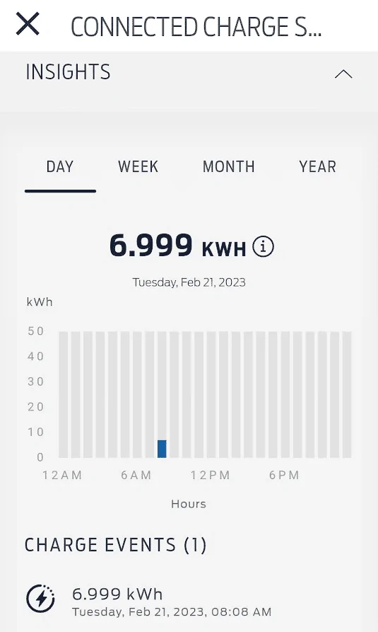

Has anyone else noticed data accuracy issues with the information reported by the Ford Charge Station Pro and the Connected Charge Station subapp within FordPass?
Other than the data being held hostage within this app only and Ford not providing the important real-time charging data to users (e.g. actual power in kW, total kWh charged, etc.) consistently or in a way that users can access outside the unreliable FordPass app on their phone, I'm finding the information reported in the app to be inaccurate.

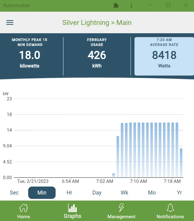

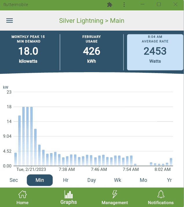

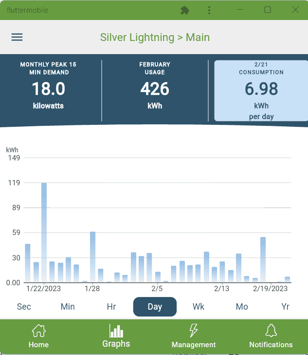

For example, yesterday I charged my F150 15% via FCSP, so that should be 19.65kWh. FordPass shows 15% charged from that session, but the Connected Charge Station UI shows 25kWh charged for that event. On top of that, my Tesla Gateway shows that just 20kWh were used during that time window, which makes sense because there was very little home usage while charging at that time. And the day before, Connected Charge Station shows 50kWh of charging, but my whole home used less than 40kWh that day, so I know that it's off as well.
My point here is that the FCSP data via Connected Charge Station does not appear to be accurate. Anyone else seeing this?
