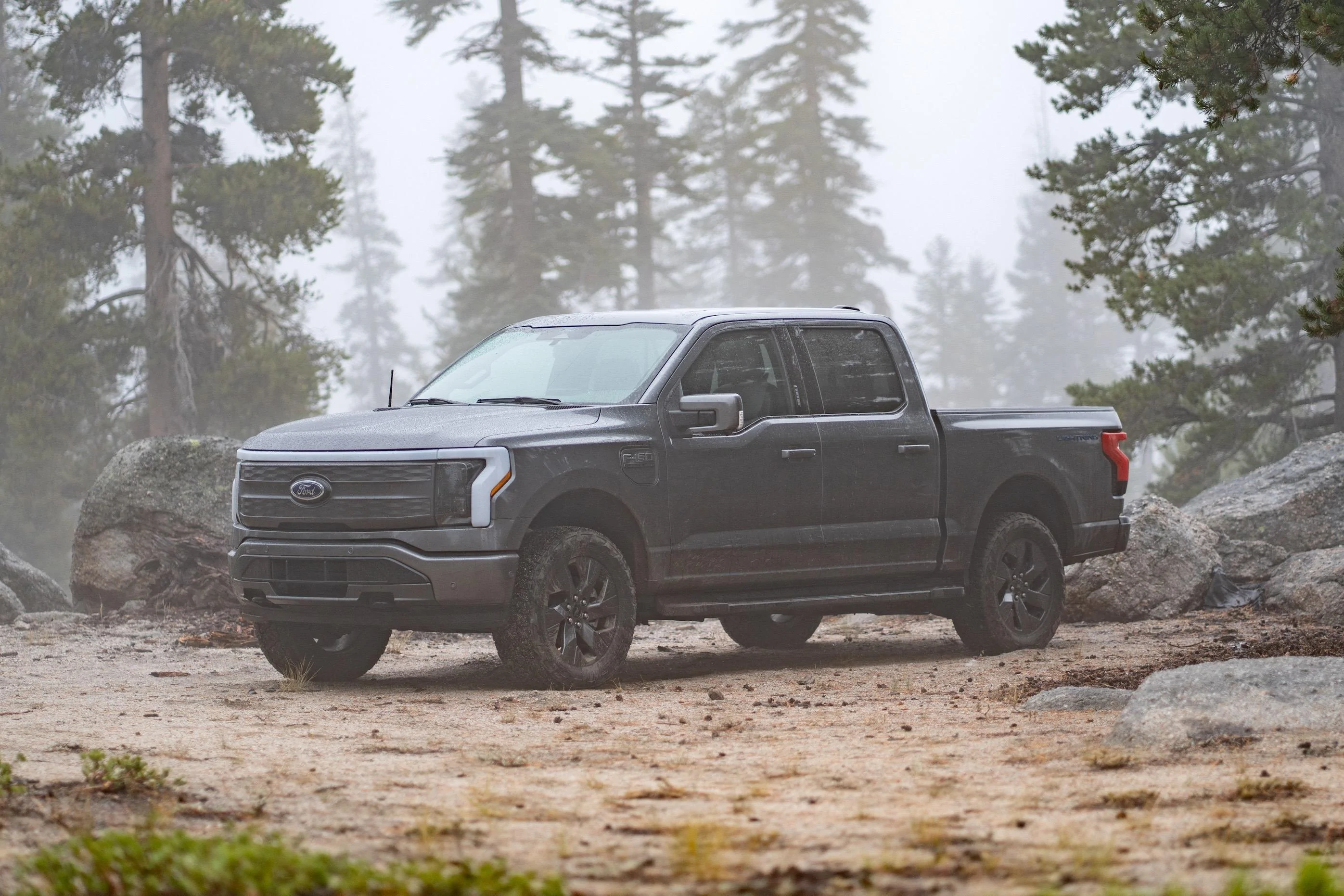

I’m in a 2022 Lariat and have Rough Country 3”. Taken it off road and helps me camping. I don’t know if it’s perfectly level, but close enough for me.

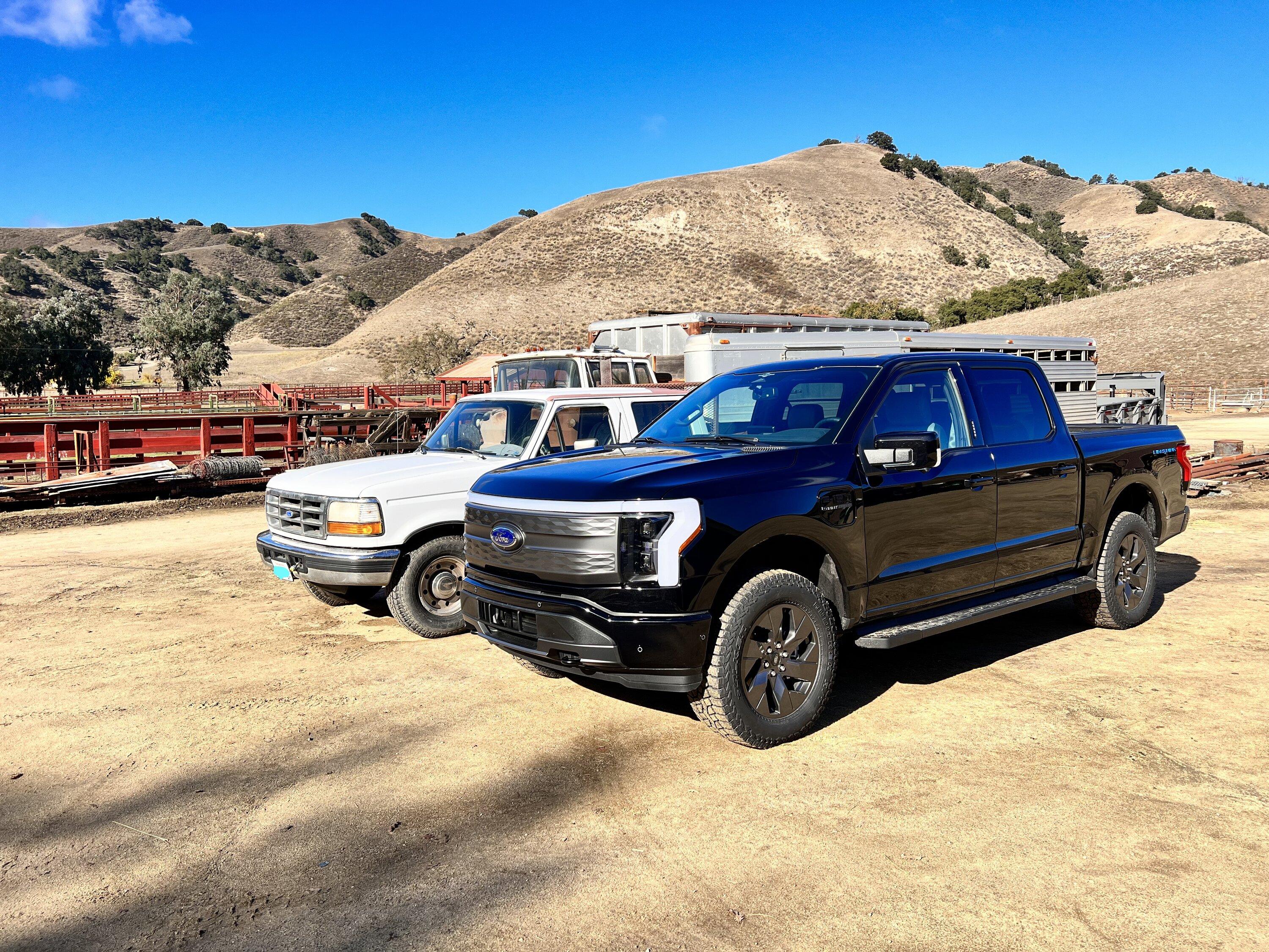

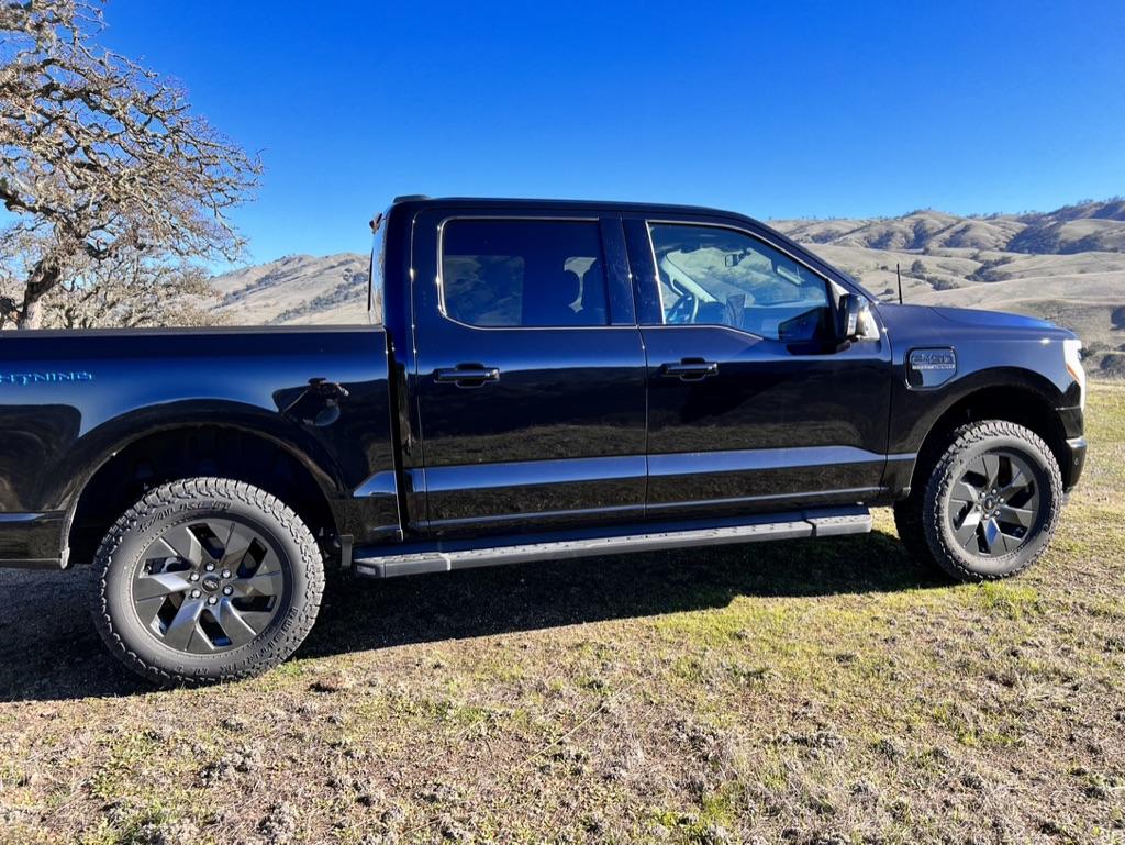

I went up to a Rubitrek LT275/65/20 size, and the 2.0" readylift leveling kit. Extremely happy with both. I really like the stance of the leveled truck with these tires. Smooth ride, tires run and wear straight, zero vibration in steering wheel at higher speeds. And love the road feel of the grippier rubber. I'm on some dirt and steep gravel roads each week, and love the confidence of the bite in the road. Just had the tires rotated, and experienced zero change to the feel of the truck, which is always a good sign to me that they are wearing evenly. There's a slight change in road noise over the OEM tires, but not a bothersome sound at all, to me.
I have over 8,000 miles on the truck. The first 3,000 on the OEM tires, and the last 5,000 on the Rubitreks. I got 2.2 miles/kWh on the OEM tires, and have gotten 1.8 miles/kWh with the Rubitreks. (Although, it also started getting into winter temps as I put the Rubitreks on, which I'm sure has also had some effect.) And zero impact (that I can tell) to BlueCruise -- which I use a lot.
