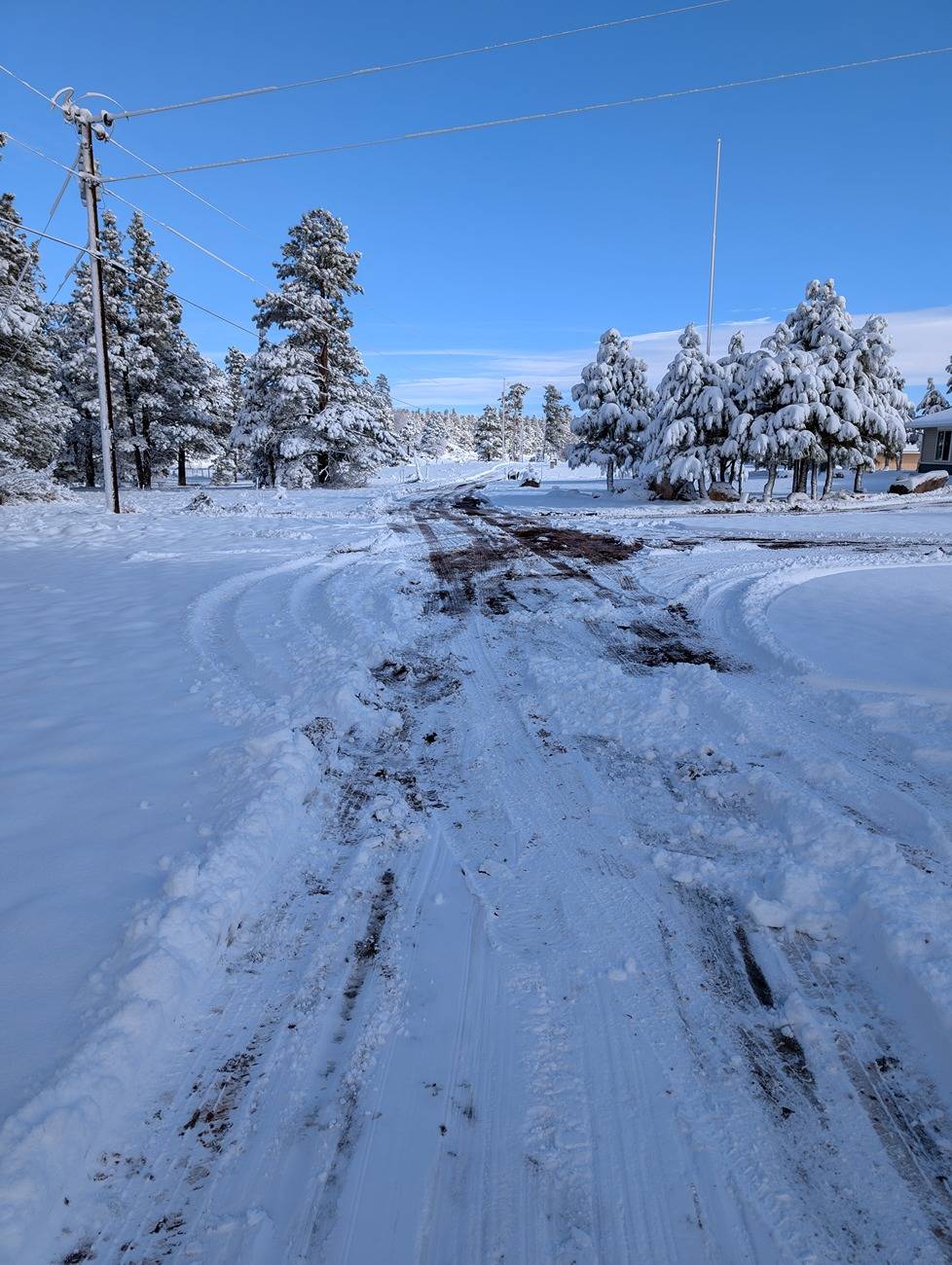

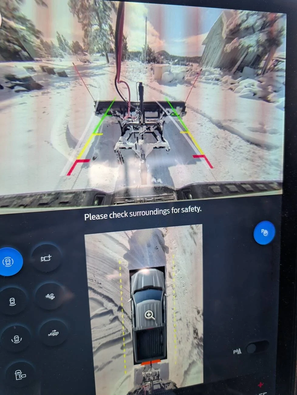

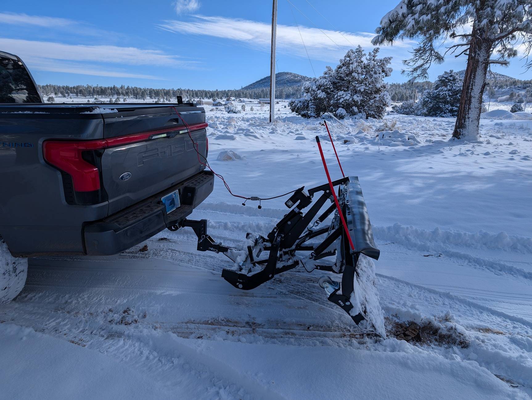

I attached my plow to the rear hitch. It works great.
Ford F-150 Lightning Lightning Snow Plow? PXL_20250314_154601781.RAW-01.COVER~2
Ford F-150 Lightning Lightning Snow Plow? PXL_20250314_155039492.RAW-01.COVER
Ford F-150 Lightning Lightning Snow Plow? PXL_20250314_154623476.RAW-01.COVER
