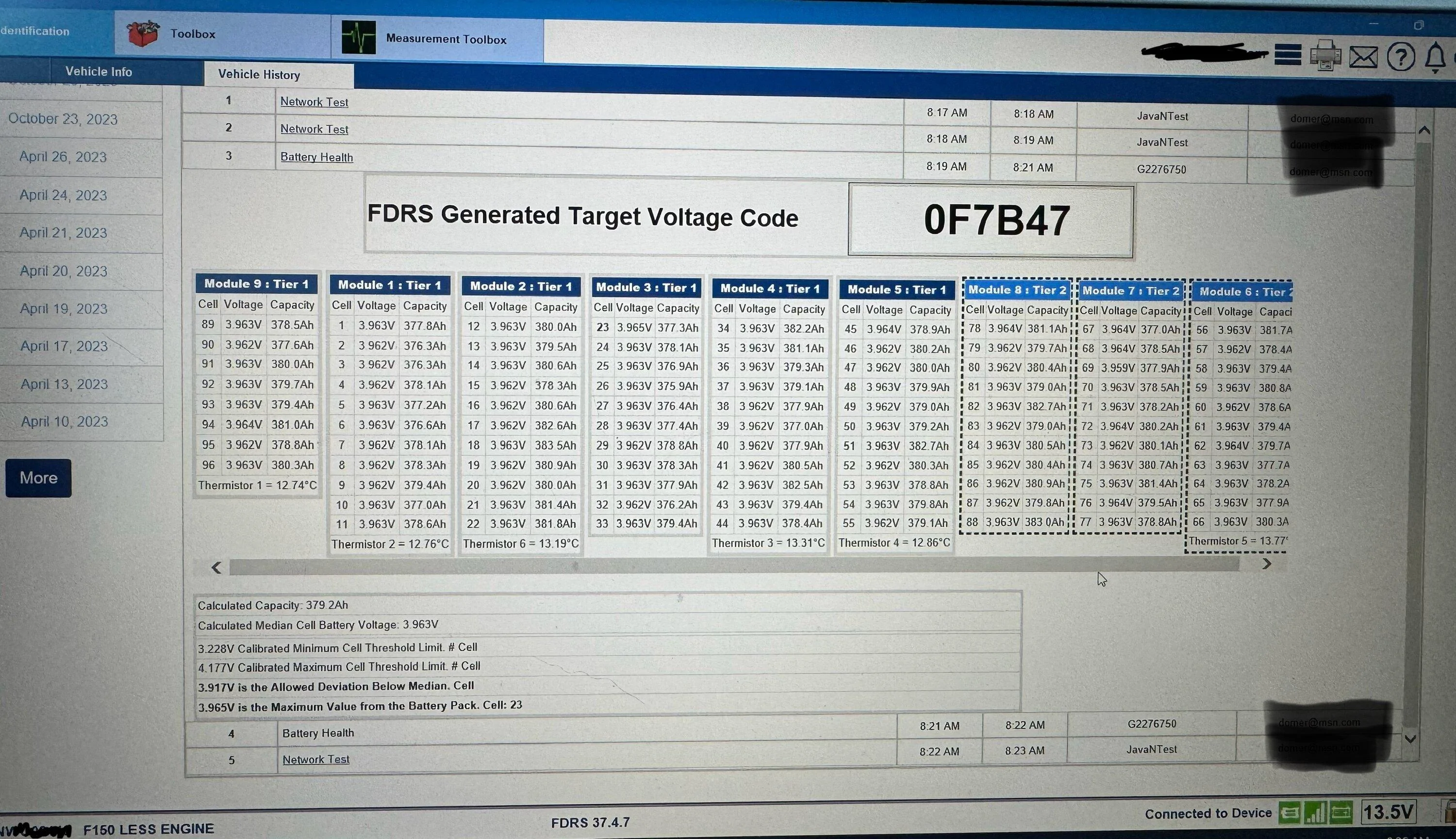

- I did the becm update - does anything happen(notification) or is it on the back end for Ford to see if I have a bad module?
- did APIM update - took about 1.5 hours - is this about average/normal? Decent PC and good internet & WiFi speeds.

1) If you didn't get a message in FP or on the IPC after updating the powertrain modules (incl BECM) I guess your battery cells are within tolerance and you've dodged the bullet. :p I think I said somewhere on another post that if somebody was going to take it to the shop to have this done they might think about cleaning out the center console and the back of the truck just in case the BECM shoots up a star cluster right after it's updated and the truck then has to sit at the dealer until the replacement cell(s) come in. I also think this whole issue is a bigger problem for very late summer '22 builds and all '23 models. I think that most of us with Mar-Jun '22 builds have nothing to worry about. That's just my own personal opinion.
2) that APIM update was 6GB and took a longish time to download but even longer than expected to copy over and update from the USB drive once it was inserted. I actually thought something might be wrong for a few minutes but then it popped up finally and said to shut down and leave the door open for 10 minutes. I've only seen one APIM update larger than that one previously, so it was substantial.

If you've got FDRS - after the update or somewhere it populates the actual data about all of the battery modules. You might be able to load up FDRS and pull up that update or poke around in screens to find your actual data. However as @Mike G notes too - if your truck didn't flash messages and say take me to the dealer, then you are likely OK.

It’s the battery health test in FDRS.

my battery health test?
Yup. Looks like there's no issues deviation-wise. Your truck probably would have reported you to the Ministry of Magic by now if there had been a problem.
