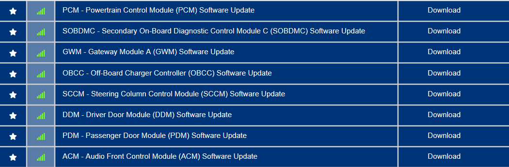

Was hoping to see if there are any software updates in the queue for my 23 Lariat. I’ve had it for months now and have never gotten any update - power up or sync. I’d love to get the Apple Maps update and get rid of the phony “100” by my battery meter.
The vin number is 1FTVW1EVXPWG27861
Was there other info needed? Sync version 22326 I believe

No OTA in your queue at this time. Modules pending updates are below:
Ford F-150 Lightning Lightning Software Updates using FDRS 1702340209214
Really appreciate it. Are any of these things critical? I’ve been waiting for the dealership to tell me when they can update the truck but it’s been a few weeks. Would these module updates prevent an OTA from popping up?
GWM would be the one that may kick off more.
