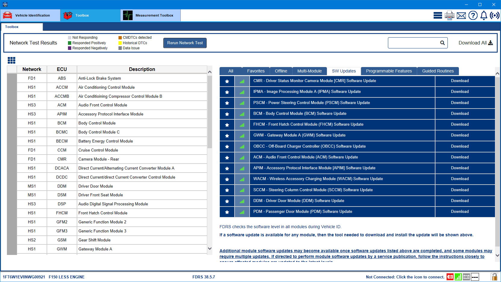

Anyone care to check and see if they notice anything blocking updates on mine? 2022 Lariat ER, hasn't received OTA updates in at least a year (if ever). It was previously a demo vehicle at the dealer, I'm wondering if that has something to do with it.
VIN: 1FT6W1EV8NWG00921
My subscription to PTS is limited compared to @rugedraw but it says on my screen that you have a "Notification of Update pending"...which means you need to go take a drive and then hit the check updates button to see if anything shows up.
As far as FDRS shows..yeah, you do have a minor problem.....simply the fact that you have both a GWM and an APIM in your list at the same time is an indication that you'll need to get somebody to update that GWM (gateway) and then the APIM (and any TCU, GWM or APIM that pops afterward) to get yourself "unstuck". Normally GWM, APIM and TCU updates are never in the lsit at the same time because of software dependencies. You do one...then the next one becomes available, and so on. But something's gotten your downloads and updates out of whack and you need intervention to get sorted. There's a whole new Sync UI waiting for you that most of us got about a year ago now....

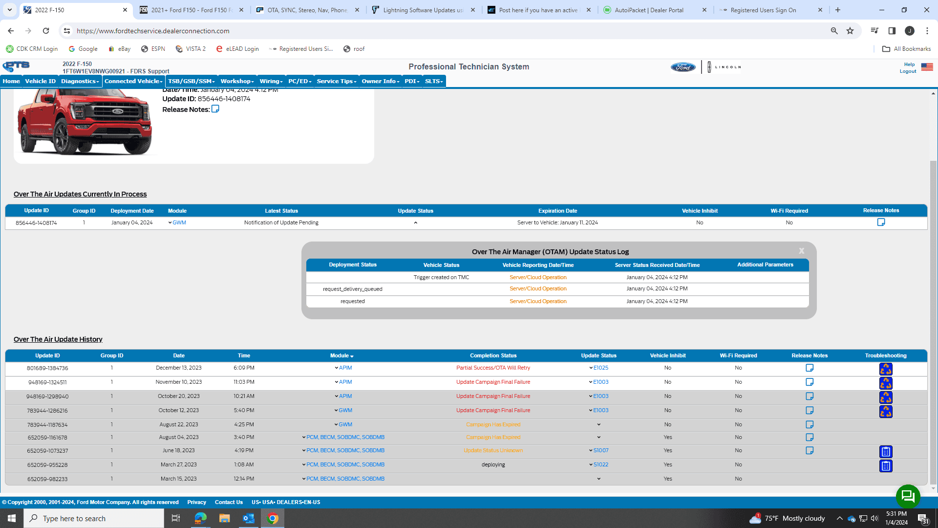

@HockeyJoe
GWM update 23-PU0503-CON-FX was sent to your truck about an hour ago. You need to start it to activate the OTA trigger.
Your OTA history is showing some struggles with recent OTA's. APIm OTA 23-PU0724-DOM-RS failed twice and th emost recent APIM update that partially installed was 4.2.2.

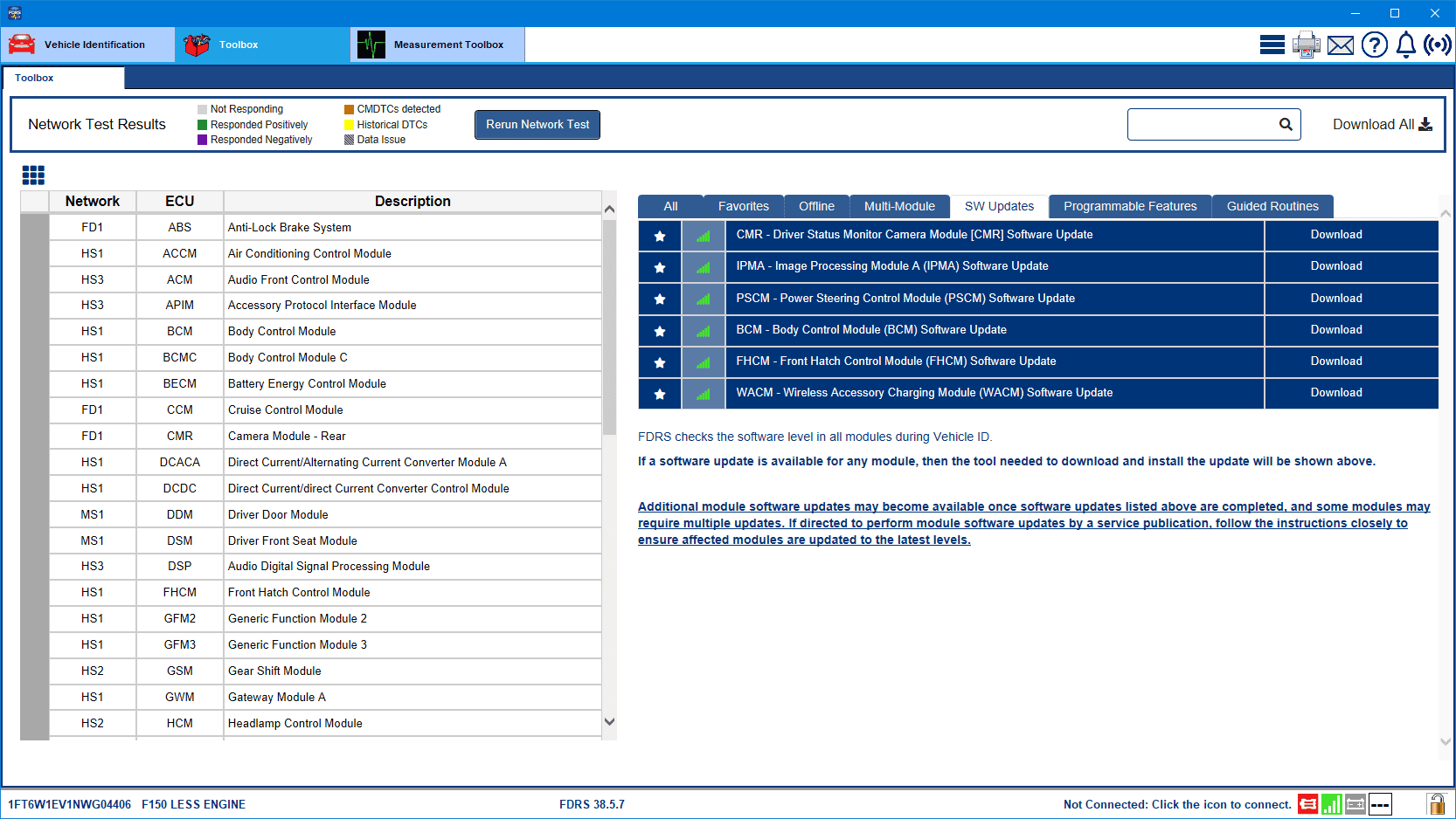

Which updates are currently available for VIN 1FT6W1EV1NWG04406? I had the sync software updated at dealer Thursday 1-4 and requested they update everything else is possible. Will the updates be available for OTA if any are queued?
Nothing in queue as far as OTA's go. FDRS I can check for you later when I get home. Message me at or after 7pm eastern to remind me.

@kWfart @rugedraw Javier, I'm behind the keyboard now so I'll post it for you.
Here's the list this morning:
Ford F-150 Lightning Lightning Software Updates using FDRS 1FT6W1EV1NWG04406-6-Jan-24
No programming took place on the 3rd, 4th, or 6th (I assume that's when the truck was in the shop). The only interaction with FDRS was on the 4th when a Network scan was run to check on available software updates and simply to reset some existing DTCs (errors). That's it. No other programming or updates took place.
