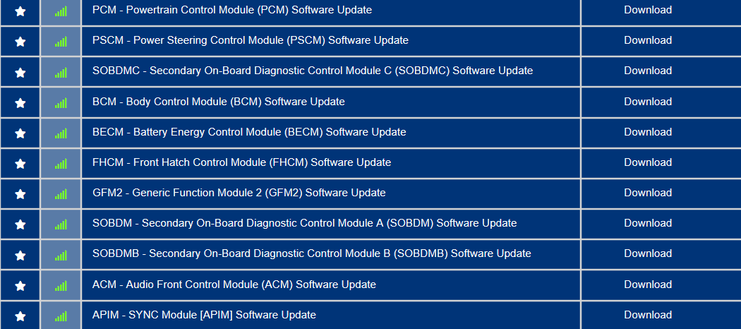

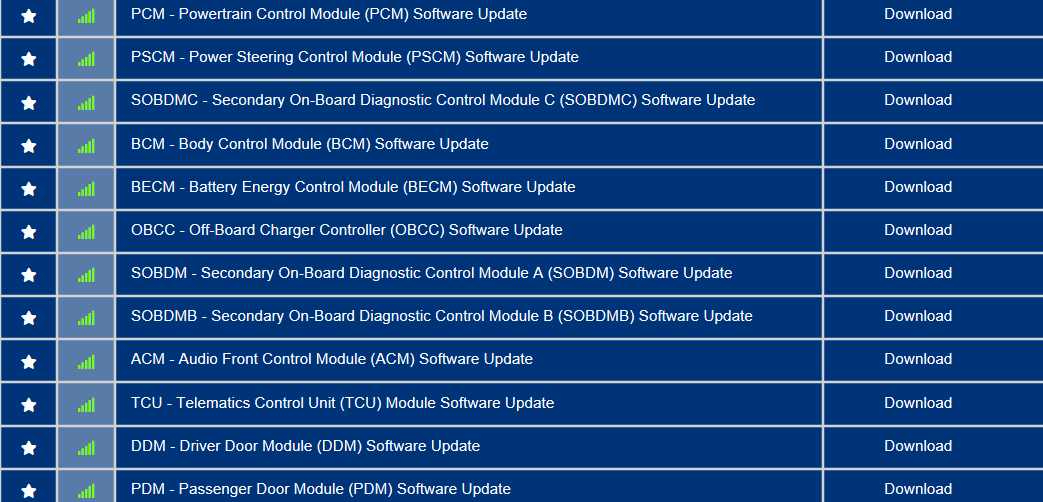

List of modules pending updates for your truck is below. Based on your OTA history, the update you want is the APIM at the bottom of the list that would be the equivalent to 6.3.0.
Your list is below. The update you are looking for is being sought after by many here, but I have yet to find an IPC update pending on any Lightning I have checked.
Thank you for checking ?
This is really helpful, thanks! I’d imagine all of these would eventually come with an OTA?
Mine is going in next Tuesday for the 23B57 campaign, so I’ll ask them about these while I’m there.
Some of these modules are exclusive to the Lightnings, so I'm not 100% sure, but I'm pretty darn sure these are all available via the OTA process. If anyone knows otherwise, feel free to chime in and correct me.
All but three in that list are "powertrain" and covered under the 23B57 update.
The three that aren't would be the ACM, APIM (Sync), and the FHCM. And from what I've seen there are OTAs for the ACM and APIM but not for the front hatch module (yet).

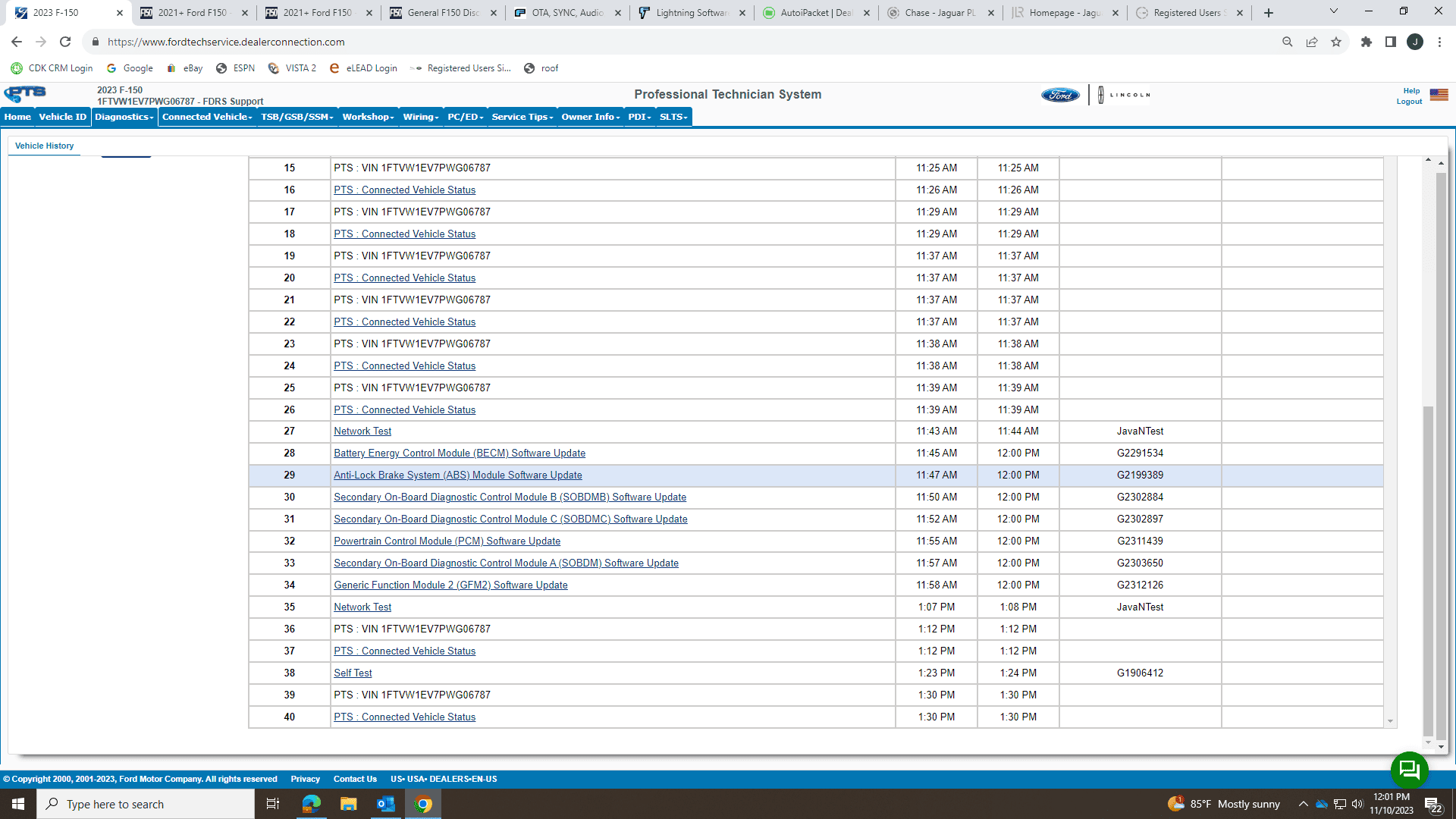

Could any gurus check the status of updates for my VIN? I had taken my truck to get the CSPs done and I'm not sure they actually did anything for the BECU update. I had reduced power last night and just want to know if I need to worry about the truck bricking if this is the lead into a bad module.
1FTVW1EV7PWG06787
1FTVW1EV7PWG06787
Last OTA you got was APIM update 23-PU0724-DOM-RS on 10/18. No other OTA's in your queue at this time. The module updates the dealer did are below and the BECM is one of them. I clicked on each one, and each update attempt was successful. There are no significant events or DTC's recorded in your recent history.

Perfect! Thanks a ton! It does look like my issues above are related to the charging glitch. After taking it off the plug and keeping an eye on it, I didn't have any reduced power issues today.
