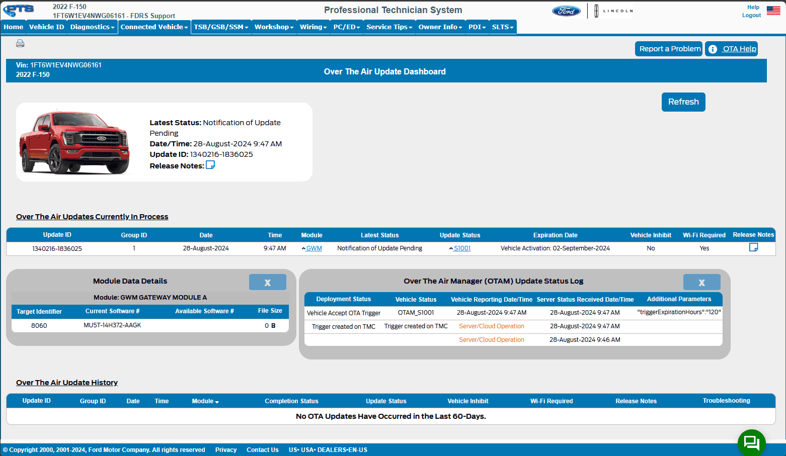

So I was looking up something else on PTS and saw this just now (wasn't there earlier this morning)
Ford F-150 Lightning Lightning Software Updates using FDRS Lightning_OTA_Notice_28_Aug-24
And when viewing the details:
Ford F-150 Lightning Lightning Software Updates using FDRS Lightning_OTA_Notice_detail_28_Aug-24
Zero byte file size? And Wi-Fi is necessary? :unsure:
FDRS doesn't show anything right now, but then again I haven't actually gone out to the truck to connect and run a network scan (it might actually show up then). We'll see.
The 23-PU113-UNX-DC TCU connectivity update is the same way. 0 byte size because all it did was change the config in one location, so I think it is safe to assume this does the same thing. That was the first OTA I ever saw that said wifi was required.
I'm out at the truck now connected up. FDRS still only says I have a TRM update available and the GVMS blocks are still there for the powertrain...but the Check Updates screen says it's downloading the update (truck is on house Wi-Fi right now as well).
Don't have any idea how long the download is...it might have already concluded for all I know, since it never actually says when it's finished downloading.

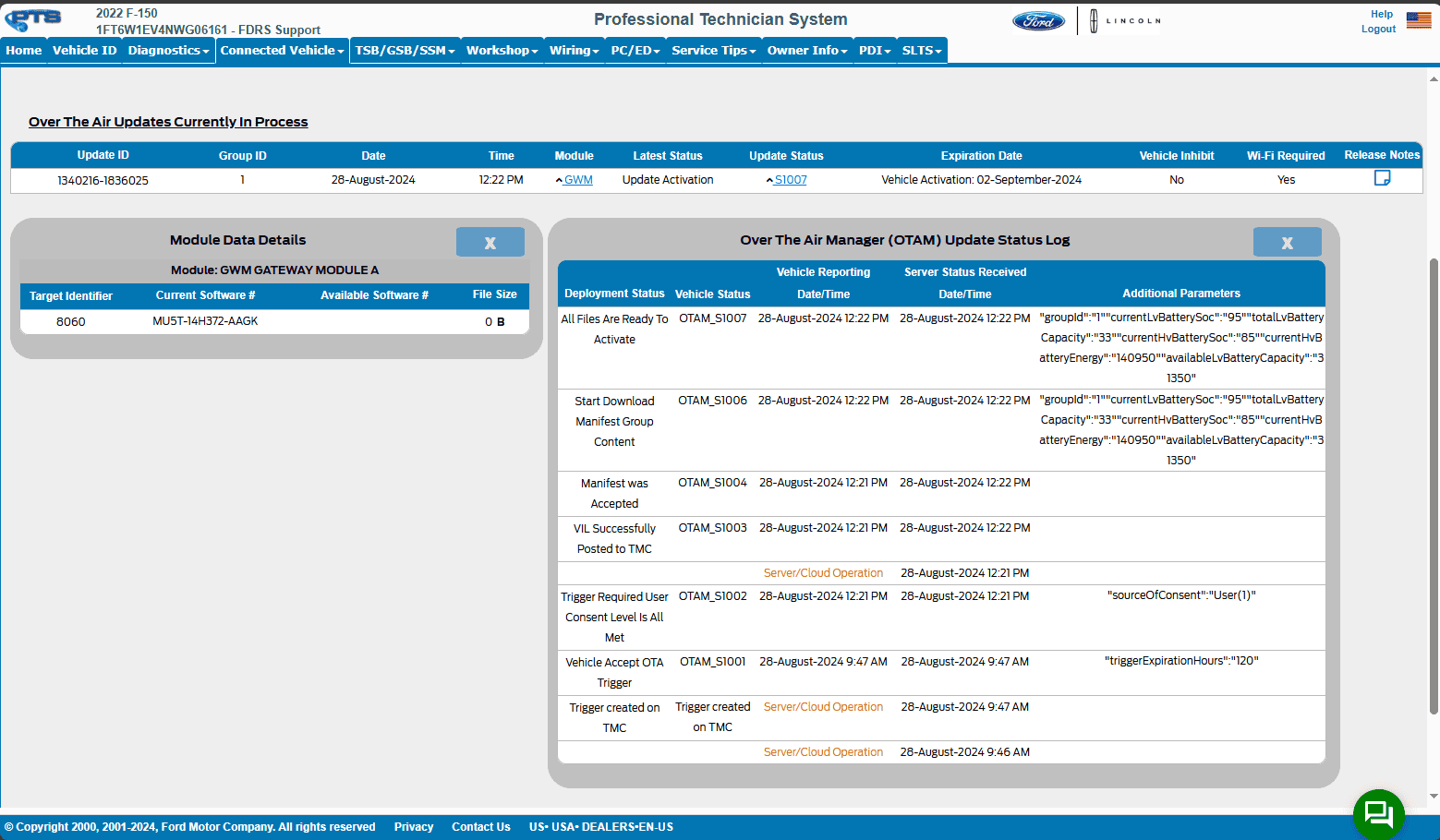

So having checked PTS again, I guess I can shut the truck down since it looks like the OTA is ready to launch.
Ford F-150 Lightning Lightning Software Updates using FDRS Lightning_OTA_Notice_detail2_28_Aug-24
After checking PTS again after shutting down it says it was successful and was listed as "FIRE-PRD-SOFTWARE-FNV2" for the gateway.
Not sure if it was as much an update as it was a test to see if my truck was 'paying attention'. :rolleyes:
No files were harmed during this update apparently.
