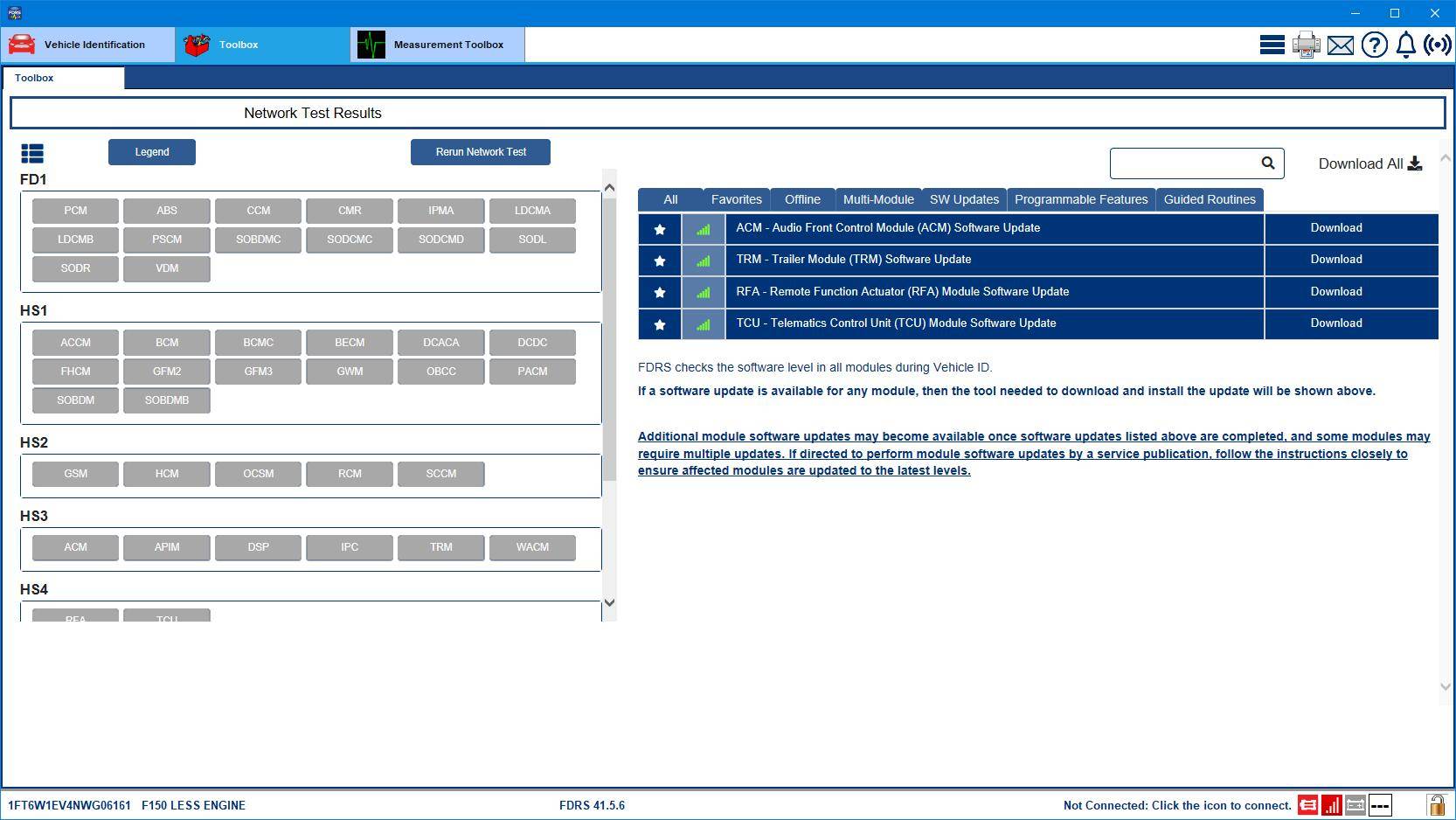

New TCU update . USB based. Installing
Now . Started 4:45pm EST . File size was 192mb I believe. Would be nice to get something good here.

Update. : completed at 5:02est. No issues. No battery tender needed as the truck stays at on the entire time . And for anyone that cares .. ACM and RFA did not clear after this update in FDRS.

Ford F-150 Lightning Lightning Software Updates using FDRS Lightning_TCU_Update_7-Oct-24
..but you beat me to it. Strange to have an update show up in FDRS on a Monday...haven't seen that in a very long time.
