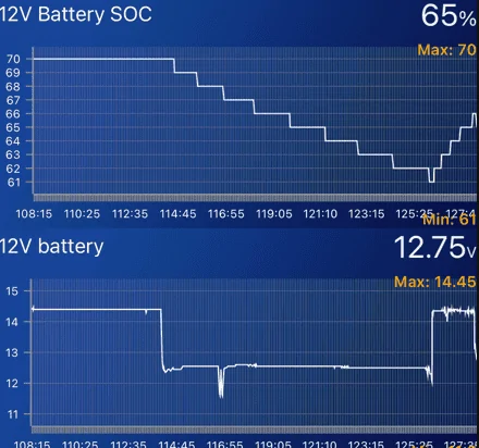

How high is the voltage on your low voltage battery when the vehicle recharges it? I see upwards of mid-15.x V on the auxiliary outlet.
The highest I have seen using CarScanner is 14.45 V. This was when trying to get the 12V SOC up after a failed update.
Ford F-150 Lightning Low Voltage Battery during Charing 1711154890760-x1
