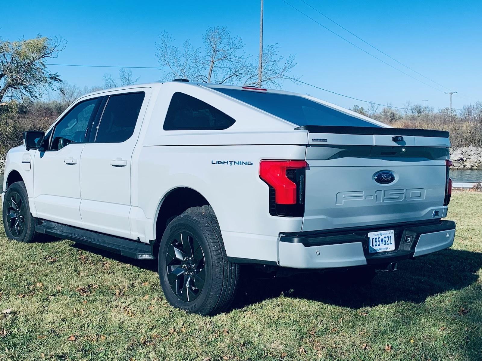

I'm not sure if anybody's still monitoring this thread, but I'm an editor at MotorTrend chaperoning a long-term Lightning test vehicle for a year. I watched Wouter Remmerie's video (touting the potential 14.8% improvement that might come from smoothing airflow from the back of the bed to the tailgate )with great interest, reached out to MVS, and they've built and installed a prototype AeroX cap on our truck. It looks awesome (see pic).
I have also reached out to AirShaper CEO Wouter Remmerie to better understand that 14.8% figure. That's relative to a baseline of ICE PowerBoost hybrid F-150 with an open bed. Hes notes that a simple tonneau is good for around 4-5 percent improvement, so we should expect more like 10% if replacing a tonneau with the AeroX hatchback cap.
Has anyone here dabbled with any aero improvements? Maybe attempted fabricating and installing any sort of underbody aero panels? I am desperately trying to slicken up our truck enough to allow me to drive 80 mph (the safest speed flowing with traffic in Michigan) without torpedoing the range. Watch MotorTrend in the coming weeks for test results.

That's an interesting add-on you have. Do you have any pics of it open? Any idea if that company is going to actually make it? Did you do any efficiency tests of your own or have any anecdotal guess on how it's affected your mileage? They seem to have some similar ones that are like 4k$ plus...did they indicate what a production one of yours might cost?

They've been producing them for the 2015-2020 F-150 for a while, but the 2021 and newer box/cab is different enough that MVS had to prototype this one. No results yet, but we'll run our full battery of range tests eventually. Note that this design was originally intended strictly for looks. Not sure if they'll productionize it.

Hell yeah. I always liked how those looked, glad to see one finally adapted to the lightning box. If they don't want it back when you're done, I'd happily give it a good home.

Oh, they’re definitely taking it back when we are done. And I don’t have shots of it open yet. Will add when it comes back.

Cool product. It has to be an aero improvement. Presumably, the space between the back of the cab and the tailgate now has laminer air flow or something close to the, whereas a stock truck would have turbulent air flow in that area. The giant flat tailgate will still create a big low pressure area though.
If someone were really interested in max range at high speed the sloped roof idea could be carried out further by opening the tailgate and fabricating a continuation of the slope to the end of the open gate. It's not super practical but would be interesting. Hint, hint @FMarkus.?

I wonder if it would be more practical to make that windowless. I would think it would lower the cost and make it more secure from thieves. It's not like you'd really need the rear-view mirror with the backup cameras and such.

Looks are subjective. I think it looks like ass. But I'm interested in your findings.
