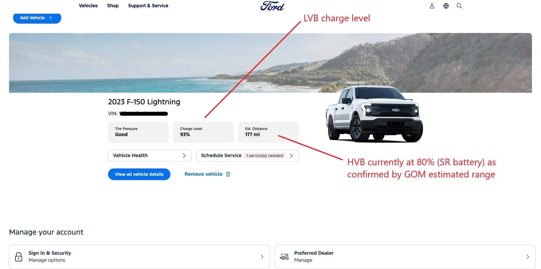

Thanks for the graph. that makes me feel like mine isn’t too abnormal.

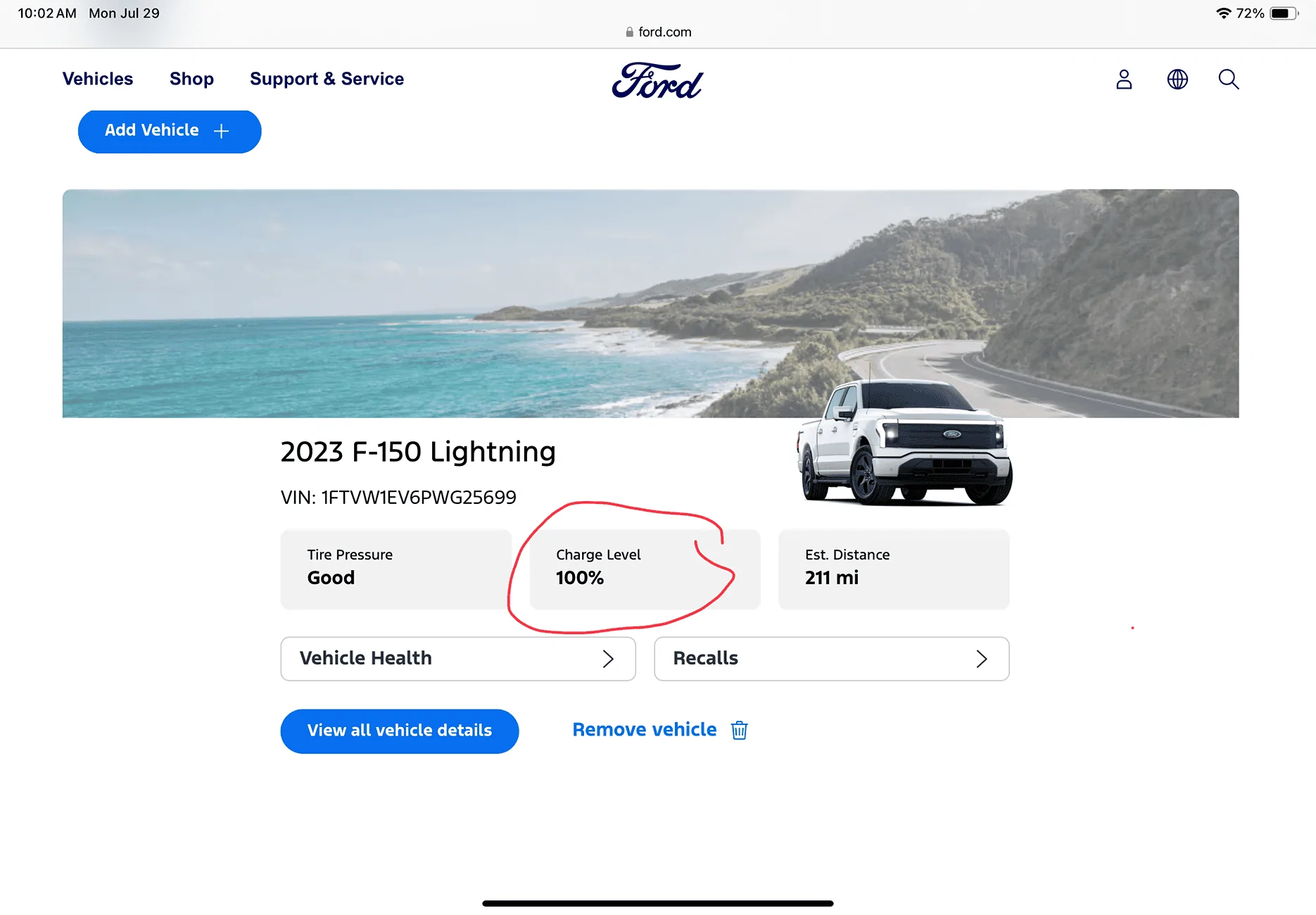

This may be a stupid question but how are you monitoring the 12 volt soc? Is this an aftermarket thing?
I just use my account dashboard on ford.com to monitor the LVB soc.

Sorry, posted wrong file:
Ford F-150 Lightning LVB “normal” state of charge? LVB charge
