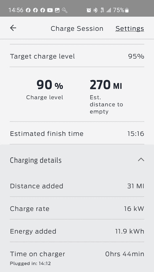

During the weekdays, I set my Ford Charge station pro to charge truck to 70 percent and Friday night after plugging in, I will set charge limit to 80 or 85 percent. I've looked all over this app but the settings for the charger will not appear. Maybe I'm missing something. I'm looking at the charge session page and it says that the target charge level is 100 percent but I don't want 100, but there doesn't seem to be any other options for setting target limit. Weird. :unsure:

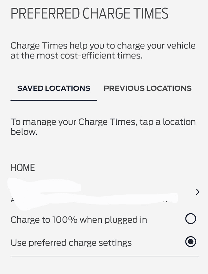

The "Use preferred charge settings" bullet should be active, tap it to adjust the factors.

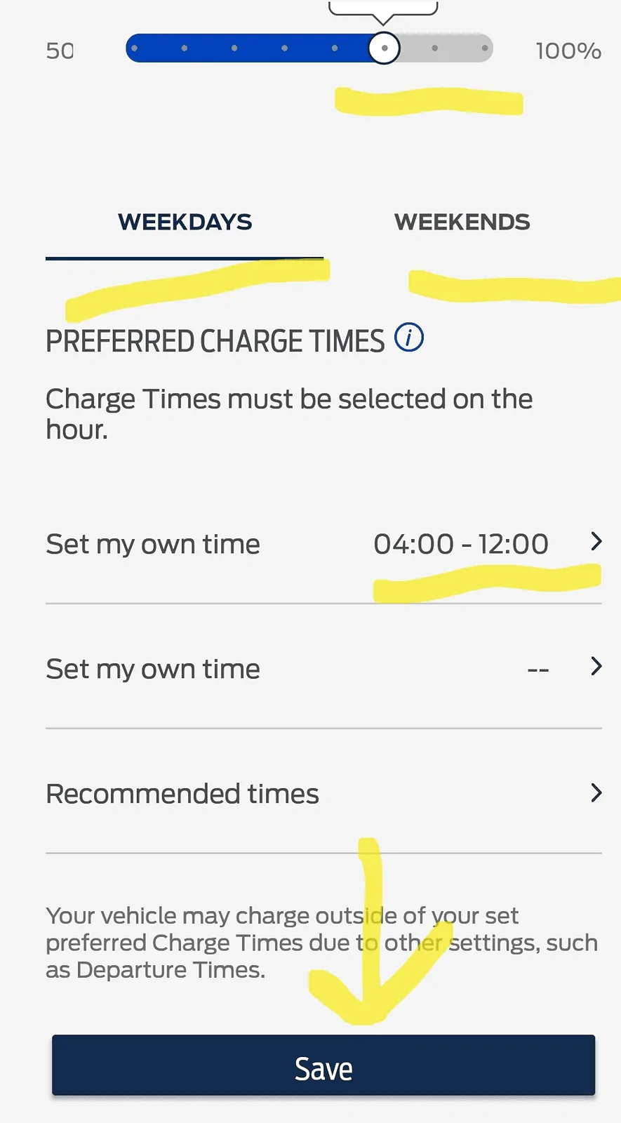

Make sure your time frames are set correctly for weekday & weekend.
Slide right/left to toggle between weekdays and weekends.
Make sure the SOC you desire has been adjusted to your higher weekend requirement, note you will need to lower this for your weekday routines.

Note these changes may not reflect on the [charging session] panel when a charging session is active, but rest assured they will be the next time you plug in.
