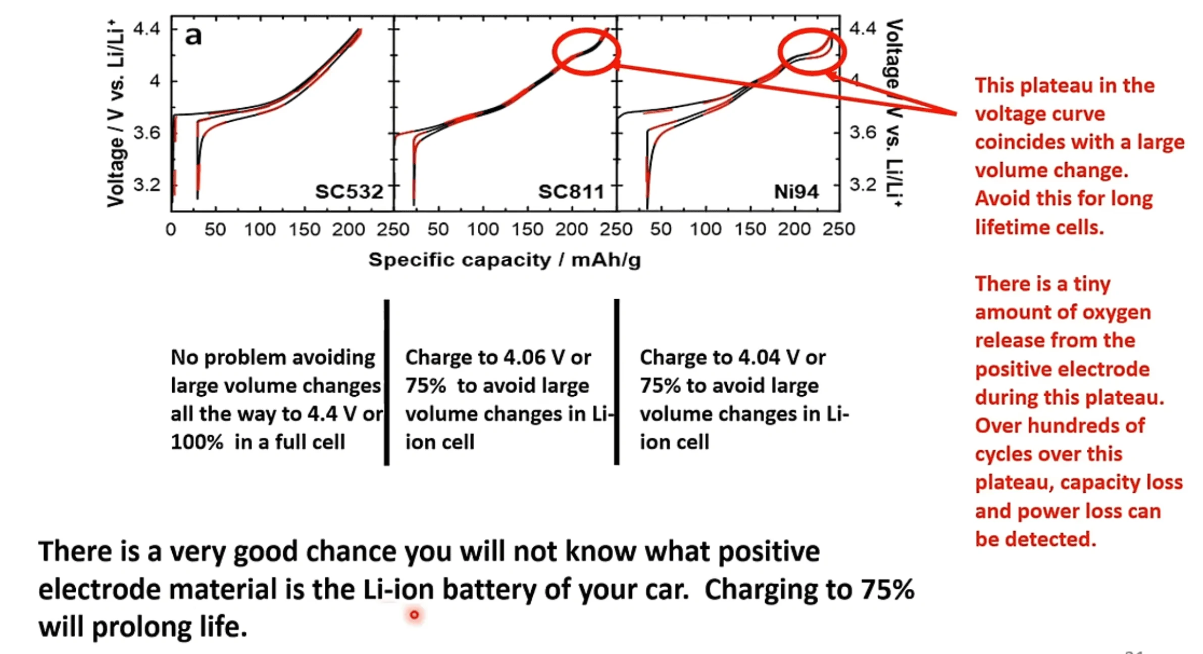

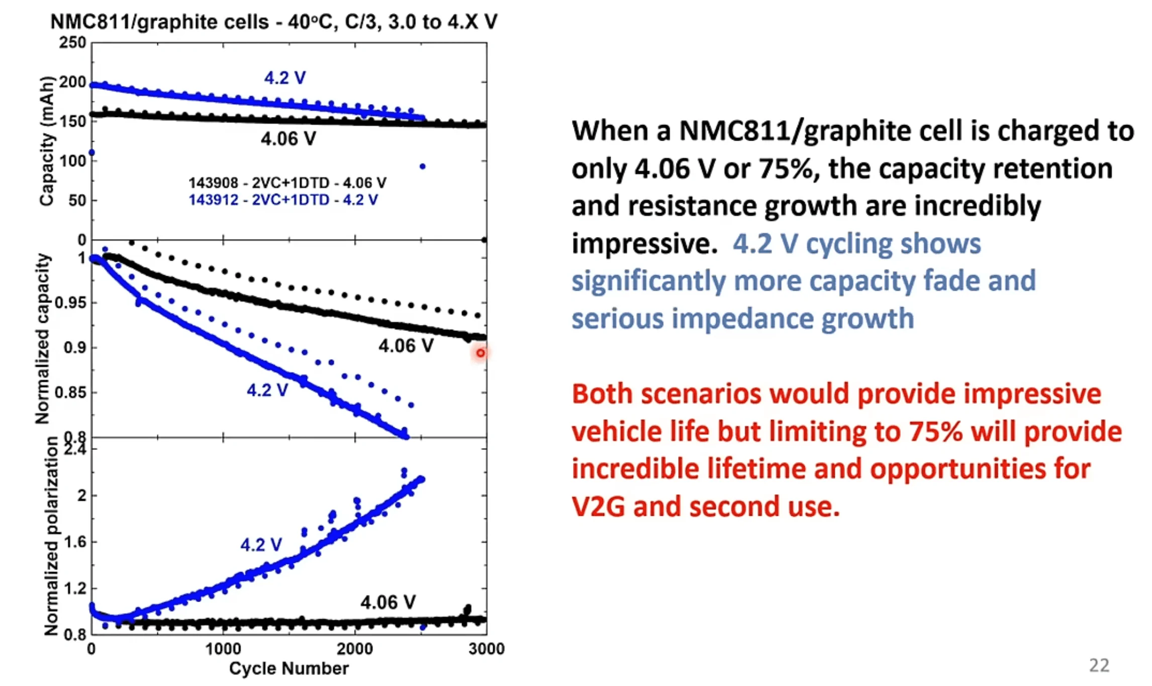

It sounds like if we do have a high nickel content battery, it may be even more important to stay out of high SOC range:
Ford F-150 Lightning 3 Common Mistakes That May Harm Your EV Battery - Engineering Explained 1706479240016
Ford F-150 Lightning 3 Common Mistakes That May Harm Your EV Battery - Engineering Explained 1706479315518
Howard_Scott_Warshaw
Feb 14, 2023
254
370
2022 Lariat ER, rapid red
~ 4 minutes - mentioned Dr. Dahn. I've brought his name up before as he is in the same class of legends as the late Dr. Goodenough (last at UT) and Dr. Judy (formally at NASA, now with UL). I have a friend that has managed to work under all three in his young career. I have replicated several of Dr. Dahn's papers to confirm and build on.
Legit did not ever think I'd see his name ever mentioned outside of academic circles. Fun fact for those of us in MA, he attended the Groton School way back in the day and provided angel funding for many of their projects on campus.
https://www.groton.org/news-detail-title?pk=1136591

So, is there a way to set my Fordpass app to always charge to 75 percent? In the app, the options are 50, 60, 70, 80, 85, 90, 95, and 100 percent settings. I want 75 percent but I have it set to 70.
