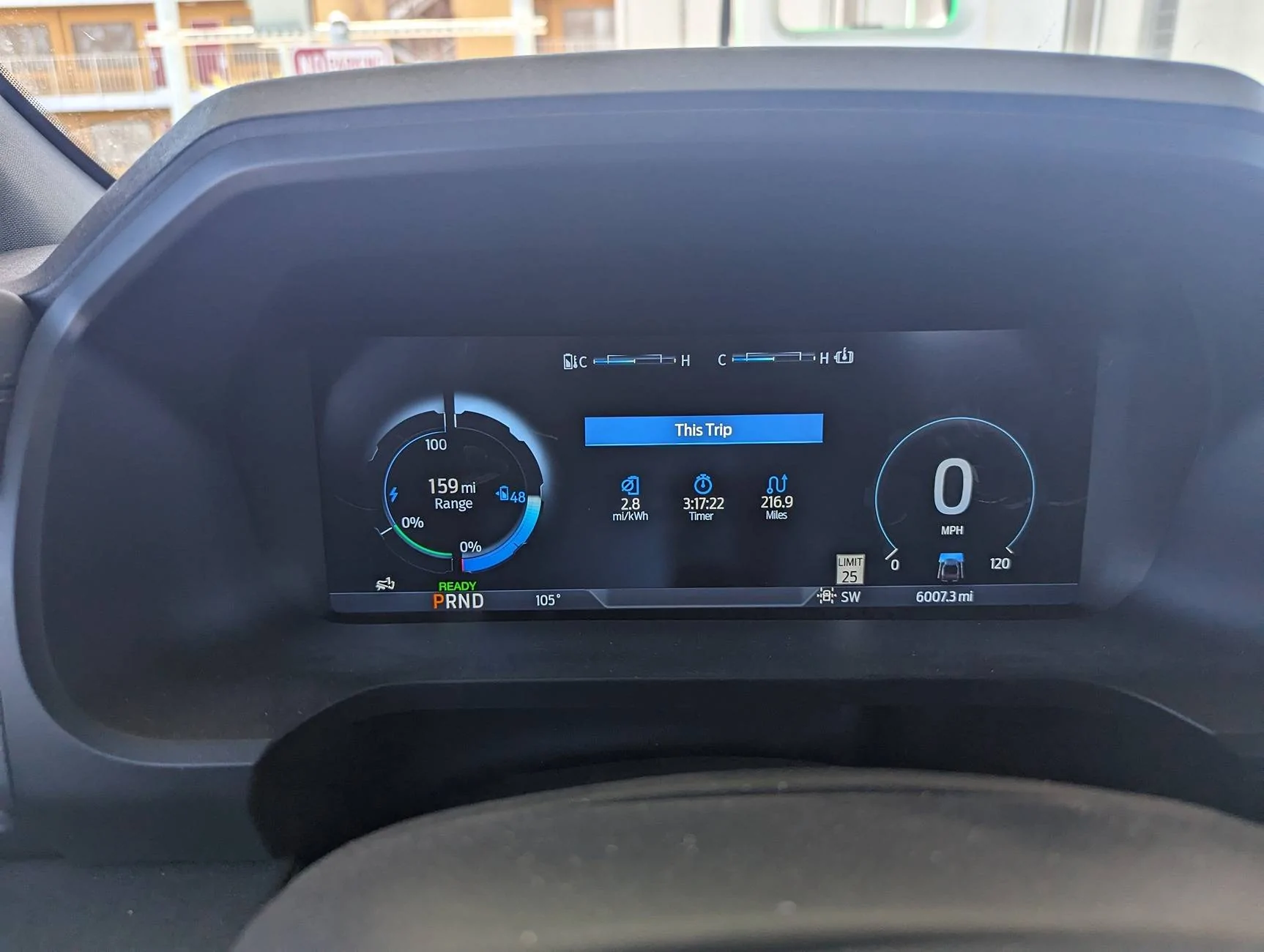

I have AT tires on my '23 Lariat ER. I drive through the Mojave Desert about once a month. My last trip was when it was up to 120 ÂşF during the drive. Doing 70-73 mph on the freeway, I got 2.8 miles/kWh. That translates to around 360-370 miles range. YMMV, of course.
At 70 - 73mph, I have never gotten anywhere near 2.8. You're getting it because you're on a flat road, with no stock and go, and it's warm.
Wow that's wild, in cdn terms that's 4.48km per kwh...at the 131 kw capacity gives a theoretical range of 580kms, above the official one of 515kms. That's like 22.3kw/100km....which I got around town but not hwy. Good work! Based on your time and distance your avg velocity was 67mph.
When I did a hwy test with the test drive truck I had, I got way less efficiency. I was doing 115-118kmh so about the same as you, and got 37kw/100km...or about 355kms range. Using 90% for driving, 5% for climate, 2% accy and 3% ext temps (was 7-8°C).
Hope I can hit numbers like yours with this!!
Full disclosure: This particular trip, which I do once every 1-3 months includes a loss (and then gain) of elevation of about 6800 feet (2100 meters). On the way down I get 2.8-3.0 miles/kWh (22.2 to 20.7 kWh/100 km, as shown) and on the way up I get 2.0 to 2.2 miles/kWh (31.1 to 28.3 kWh/100 km). So my average is around 2.4 miles/kWh (25.9 kWh/100 km) on this particular trip of 1100 miles (1770 km).
On some of these trips, the winds generated by the interaction between extremely dry and hot desert and the cool/wet coast can cause me a large loss in efficiency, sometimes bringing one long leg down to about 1.7 miles/kWh (36.6 kWh/100 km).
My lifetime (7500 miles; 12100 km) is 2.4 miles/kWh (25.9 kWh/100 km), but I don't drive this around town much--we have the Mustang Mach-E for local driving and after 43,000 miles (63,000 km) of mixed freeway/local driving, we are averaging 4.1 miles/kWh or 15.2 kWh/100 km).
We do get "cold" here, but not BC "cold." Cold weather performance will be less, potentially by quite a bit.
Great data, thanks! And that's all with the AT tires?
I'd be pretty stoked if I could get lifetime avgs on the lightning to be sub 26 kw/100kms efficiency. Heck even sub 28. Electrical prices here would put that at about $3-$3.50/100kms cost of fuel.
Tad bit better than the 12-13L/100km ($20-$25) cost of fueling the ICE version!
All with stock Hankook AT2 275/60R20 tires--note that these are not the BFGoodrich AT tires that some trucks were shipped with.
I run them up near the top of their pressure profile, rather than at the recommended pressure on the door jamb sticker. At some point I'll buy a set of lighter-weight 18" wheels and street tires for spring/summer/autumn/road tripping and keep the 20" wheels for snow/winter tires.
