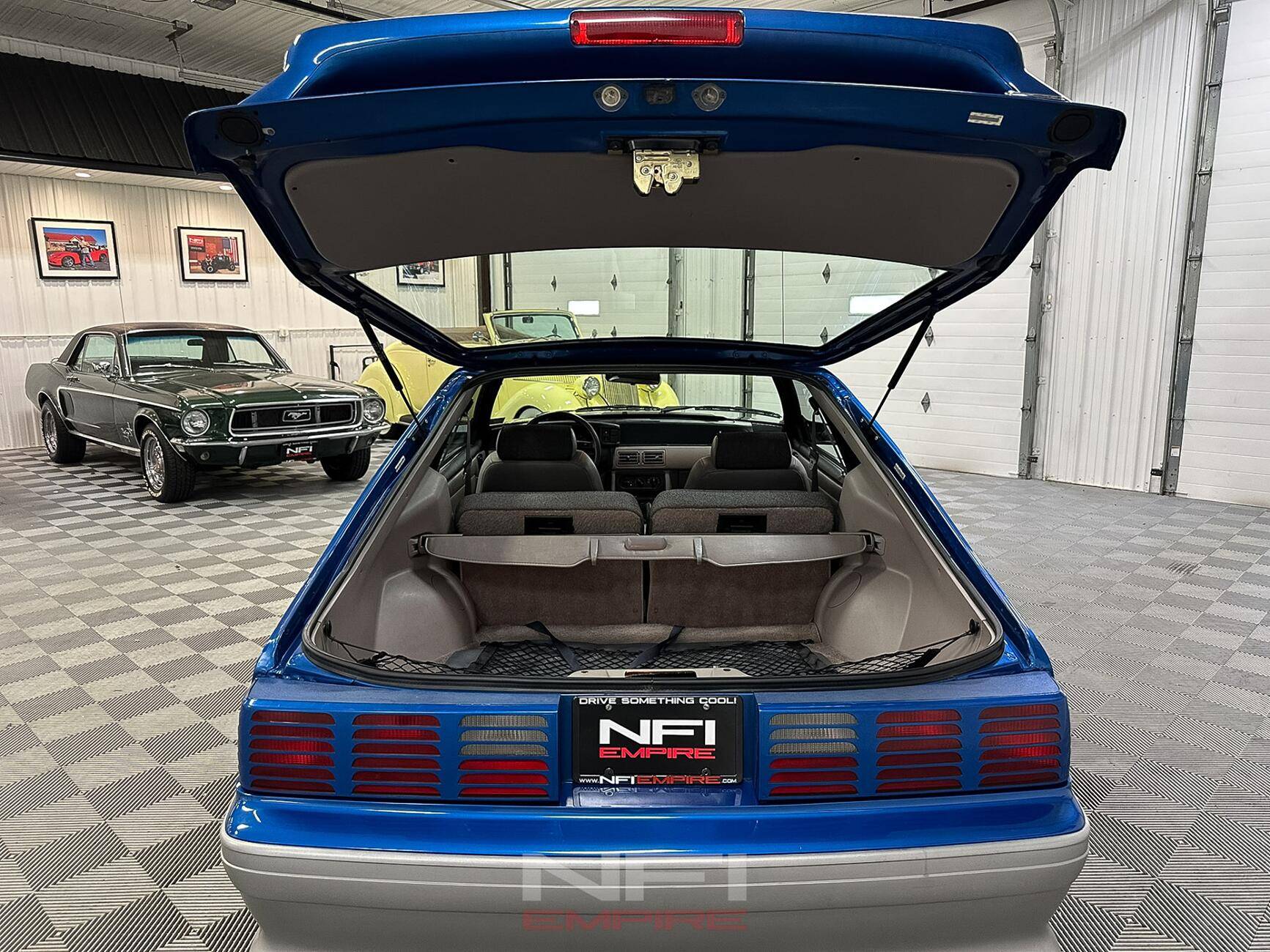

It's like the Mustang MACH E. It is NOT a Mustang. It is a MACH E, with the confusion of adding the "MUSTANG" naming. No Mustang has EVER had four doors, and CERTAINLY NOT a rear hatch!

Yup, I had one of these with a V6
I could never swing one growing up as a teen, the Camaro/Firebirds of that era (hence the user name) were in the price range of a few hundred dollars for a good V8 car to the $3000+ for a good foxbody...it never made sense haha.
Paid $500 for an '88 IROC with the 5.7 and 17yo me drove it everywhere.
(Granted this was in 2003-2004)
