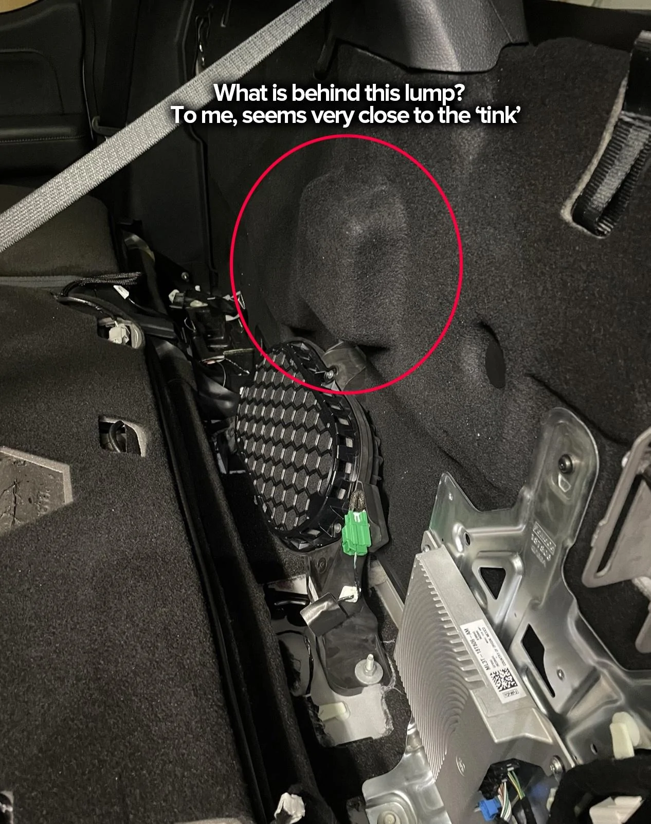

OK, last night, I laid down BOTH seats. Removed the jack and actually taped up the jack restraint to eliminate it. The 'tink' sounds still persists. I WILL SOLVE THIS. Dealership could not replicate the sound. I have to take it back and drive a tech around. But for now, I am still investigating. I may try to get in behind the cushion behind the seats and see if something is making the noise behind it. There is a large hump behind the passenger rear side, anyone know what is behind this hump?

Hmmmmmm.. and folks say it's seatbelt related.. maybe they're right?! If I open up that badboy and there is a freakin tin can taped to it, I'm going to flip out :)
