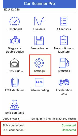

Ok I'm in car scanner now connected and in the dashboard but none of the PID are Reading anything.
Edit.. I had to pay for it and select lightning and it works now.

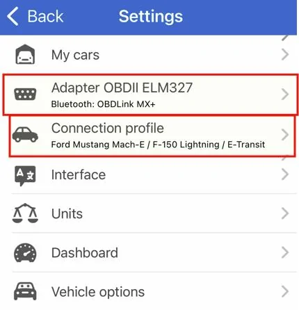

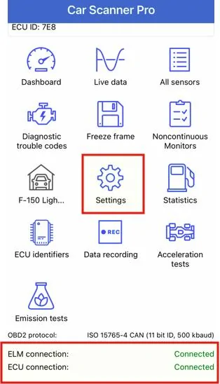

Click Settings and make sure you select the Mach-E / Lightning Connection profile and your adapter is showing.

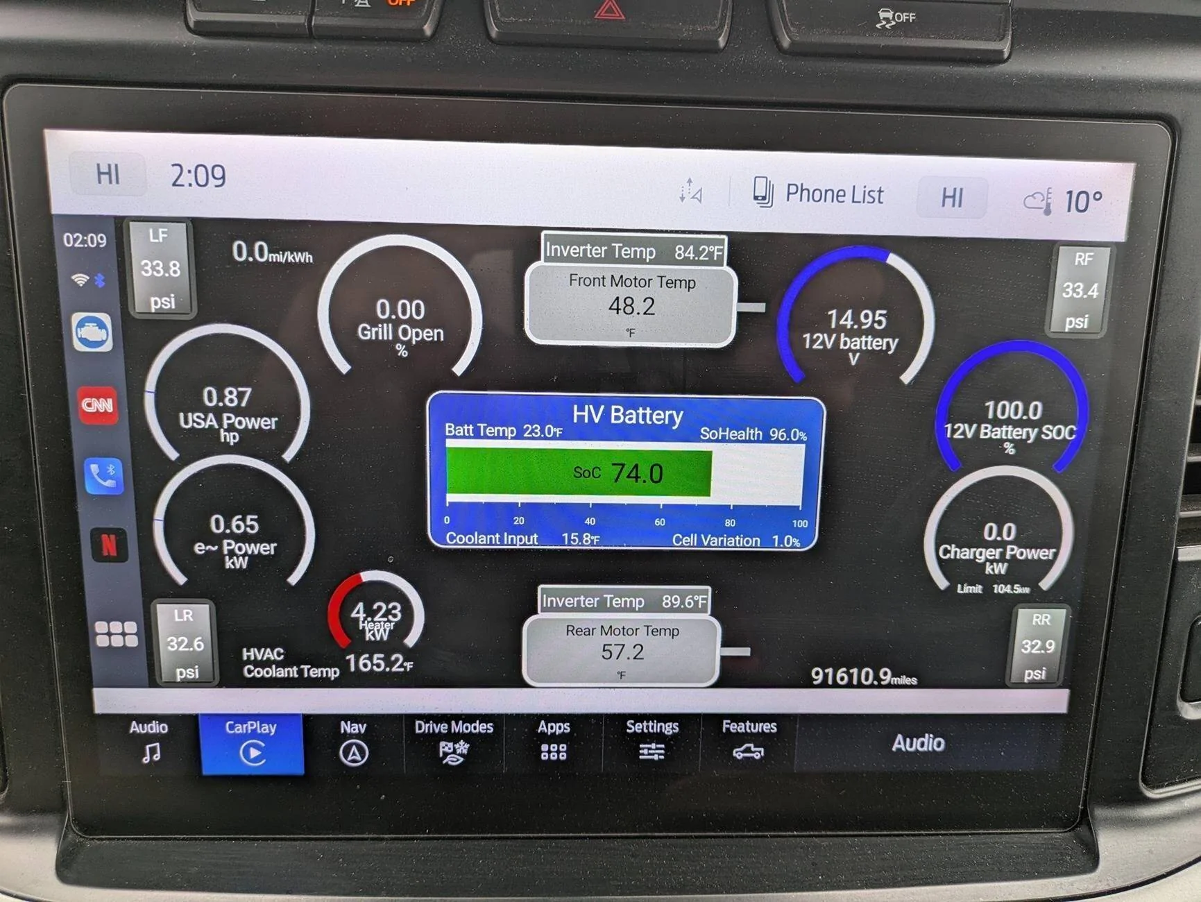

No, my post is the Android paid version running on a magic box emulating carplay.
You got a cool setup there. FYI, I was actually replying to Craig who said he had to buy it. It must be an Android thing since it is free on iOS.
