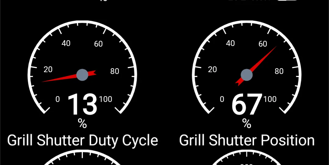

Ford F-150 Lightning My front louvers are open in cold weather? Screenshot from 2026-01-18 11-37-36

I've been curios about the louvre behaviours and would like to see a live view of them while driving in various temps.

Probably still generating waste heat at those temps.
Should be doable with car scanner.
