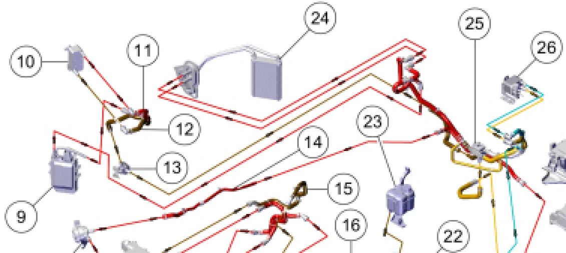

Just looking thru a 2024 F-150 service manual.
(I don't own a Lightning)
I don't see PTC heaters, only reference to High Voltage Cabin Coolant Heater.
I don't see temperature specs besides:
Electrified Drivetrain Cooling - Electric. - 2024 F-150
NOTE: Coolant temperature will vary with ambient temperature and load. Temperatures shown are for ambient temperature of 25°C (77°F).
Red arrows indicate a temperature approximately 70°C (158°F). Brown arrows indicate a temperature below 70°C (158°F).
Orange arrows indicate a temperature of approximately 40°C (104°F). Blue arrows indicate a temperature below 40° C (104°F).
Heater Circuit
The heater circuit uses a cabin coolant heater and a vapor injected heat pump water cooled condenser (VIHP WCC) to heat coolant that is transferred to the cabin through a heater core.
This circuit also passes through the high voltage battery coolant diverter valve to allow this circuit to be combined with the high voltage battery circuit for battery heating.
Climate Control System - General Information - 2024 F-150
Climate Control System - Electric, Vehicles With: Dual Automatic Temperature Control (DATC)
The cabin heater circuit provides warm coolant to the heater core to warm the passenger compartment.
A SOBDMC controlled cabin coolant heater warms the coolant.
The upper temperature limit for the cabin heater circuit is 80°C (176°F).
The cabin coolant heater reports the coolant temperature exiting the heater to the SOBDMC through the LIN circuit.
The SOBDMC relays the temperature information to the PCM through the FD-CAN.
Even though the vapor injection heat pump system is more efficient in its ability to provide heat, additional heating is sometimes required (for example in extreme low ambient temperature conditions or during a warm-up phase).
To provide this heat, the system uses the high voltage cabin coolant heater.
The high voltage cabin coolant heater provides heat directly to the coolant circuit.
Max Trailer Tow.
Ford F-150 Lightning Heat pump in extreme cold -20F 1769895764908-zv
9 Cabin coolant heater
10 Vapor injected heat pump (VIHP) water cooled condensor (WCC)
11 Cabin coolant heater inlet hose
12 Vapor injected heat pump (VIHP) water cooled condensor (WCC) inlet hose
13 Cabin heater coolant pump
14 Front coolant pump inlet hose
23 Coolant expansion tank
24 Heater core
25 High voltage battery coolant diverter valve
26 High voltage battery coolant coolers

As was stated, it is a known limitation for a heat pump, that being said, there does seem to be a heater core and PTC heater also, what I haven't seen clarified is whether the heat pump heats the coolant for heating the cab or a more direct means like it would for cooling the cab. This matters because if it's the latter, it would explain your issue, the PTC must take up the slack and it would take time to heat the coolant to a comfortable level from that temperature.

Thank you! Definitely sounds like it has a method of heating the cabin without the heat pump. I wonder why mine wasn’t working.
218
15,952
17,892
#9 the aka the PTC is supposed to kick in only when heating demand exceeds the capacity of the VIHP system and boosting the HVB temperatures simultaneously.

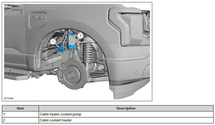

Found this.
Ford F-150 Lightning Heat pump in extreme cold -20F 2025lightningcabinheat
