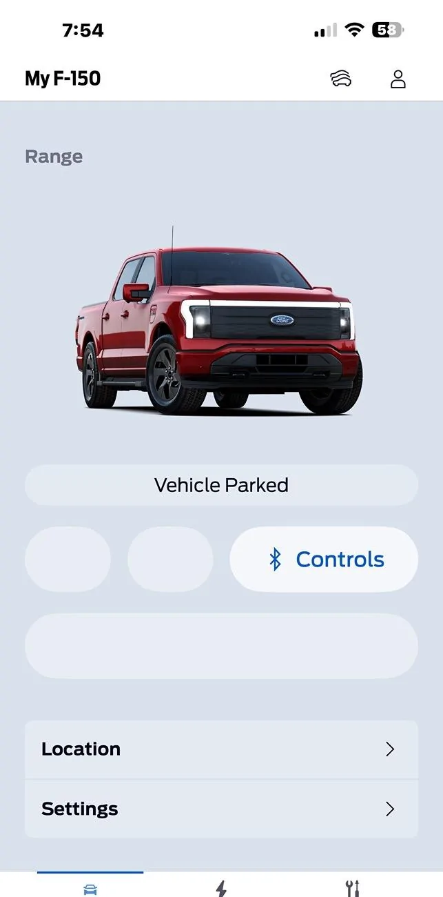

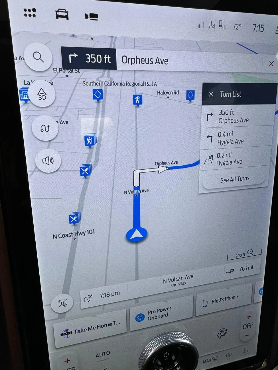

I went to the dealer today for my 10k mile service. I also asked them to look at my Nav. When I first start vehicle and use Nav and hit go I am no longer able to adjust sound for radio or phone then 10 min later it plays every turn I made and then I can adjust sound normally. Today dealer updated my SW and I got this screen (pic) but it did NOT FIX the Nav issue. I am also having an issue with my app where I can use remote lock and unlock called Ford and said a SW update coming no ETA. Anyone else have similar Nav / sound issues?

IIRC there may be settings that you can toggle to possibly correct this.

As for Ford Pass, make sure your version is up to date, confirm you have authorized data sharing consents in the trucks Sync screen, maybe toggle those off/on might shake the misconfiguration back into shape

Thanks. I’ll try. On the app I deleted and reloaded last week and I was on with ford app team. They even took my VIN and said they might need to make manual update after new app is released

Misbehaving center screen issues can sometimes be fixed by a Sync reset. To do that hold down volume down and the right "skip" arrow on the steering wheel until the screen resets. May or may not help.
