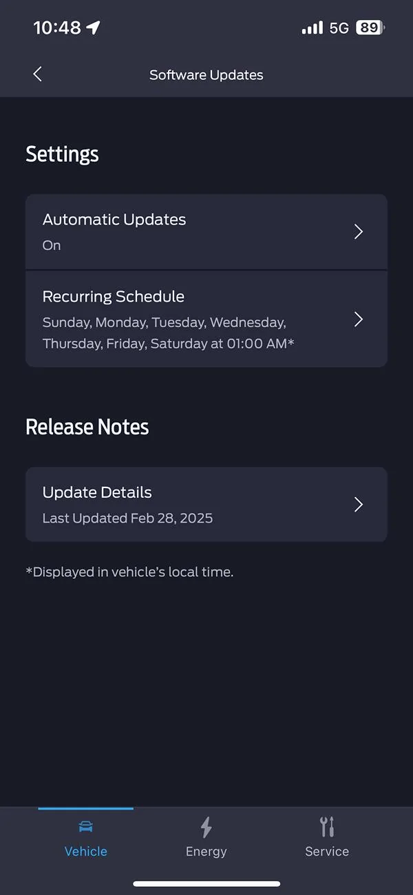

I also received BC 1.4 today, previously was running 1.0 version.
Had the CSP for front sensors completed in mid February.
Last update prior to that was 2/28/2025. ECG 24.2.5.7
