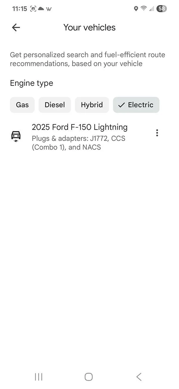

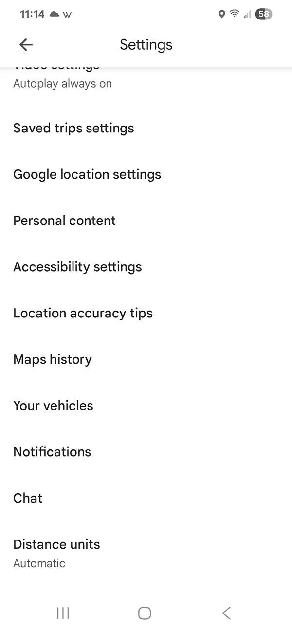

I'll be poking around this weekend updating my old truck, wife's suv and mom's muskrat while I'm at it to justify the $150 expense. I use to do this type of work at a Ford dealer years ago.
One thing to make sure you do is go into settings on Google Maps on your phone and go to the "Your Vehicles" option and be sure to select "Electric" and enter set up your specific vehicle and its charger plug types; see attached pics
