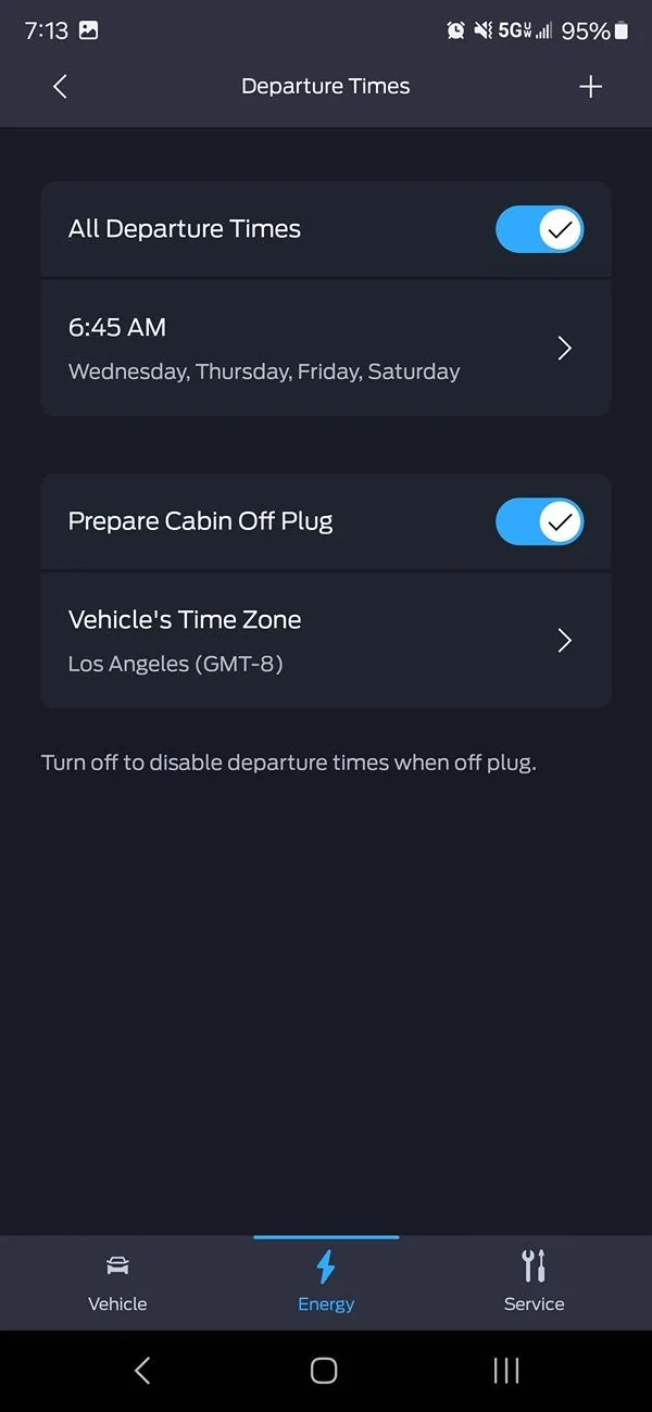

It's under my departure times in FordPass, 2023, can't post a picture right now for whatever reason but it's there and should be in yours too.

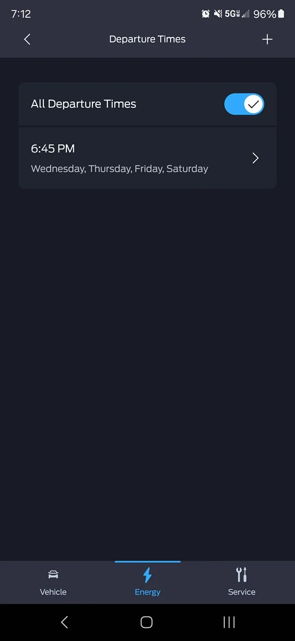

Yeah, that's where mine was for my 2023 XLT.
There is nothing there for my 2024 flash though. See Pics
Ford F-150 Lightning No way to Prepare Cabin Off-Plug on 2024 models? Screenshot_20240801_071244_FordPass
Ford F-150 Lightning No way to Prepare Cabin Off-Plug on 2024 models? Screenshot_20240801_071306_FordPass
JLWFlash
Josh
Aug 1, 2024
Portland
2024 F150 Lightning Flash
First one is my 2024 flash, second image was from my 2023 XLT

22's & 23's are fine, I also have the switch visible, we discussed this problem in a recent thread.
I also found that the switch for off plug departure time preconditioning, which is only really cabin conditioning is now missing on my 22 Lariat ER, it's been a good long minute since needing to use that switch in the truck on the sync screen.

Interesting, will it precondition the cabin off plug anyways?
JLWFlash
Josh
Aug 1, 2024
Portland
No, I was hoping that was the case. But doesn't seem to work. It's not a big deal right now with the good weather, but come winter It's a huge deal. Truck has to live outside, and having it preconditioned save me hearing it up or scraping ice before work in the morning.
