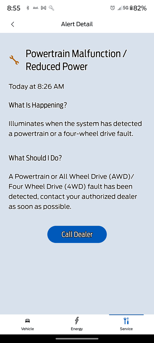

I have been getting the powertrain malfunction warning every day for a couple of months now. Now the shifter makes noise after I turn the truck off. What is going on?

I don't have audio on this PC (yeah it's a weird work PC) but based on previous postings here, I'd say you have a bad shifter. Several have mentioned getting that warning and the dealer diagnosed it as needing a new shifter.

Sounds like bad shifter motor. I always put in Park manually rather than have the motor do it, so who knows, mine may be bad too!

bad shifter motor. You can buy the part online and replace it yourself. I did it to my lightning.

I had the same service error and noise on my shifter. When I took it in the dealer said the powertrain error was pointing to a bad shifter actuator (motor to move my shifter). They replaced it under warranty and all has been fine since.
