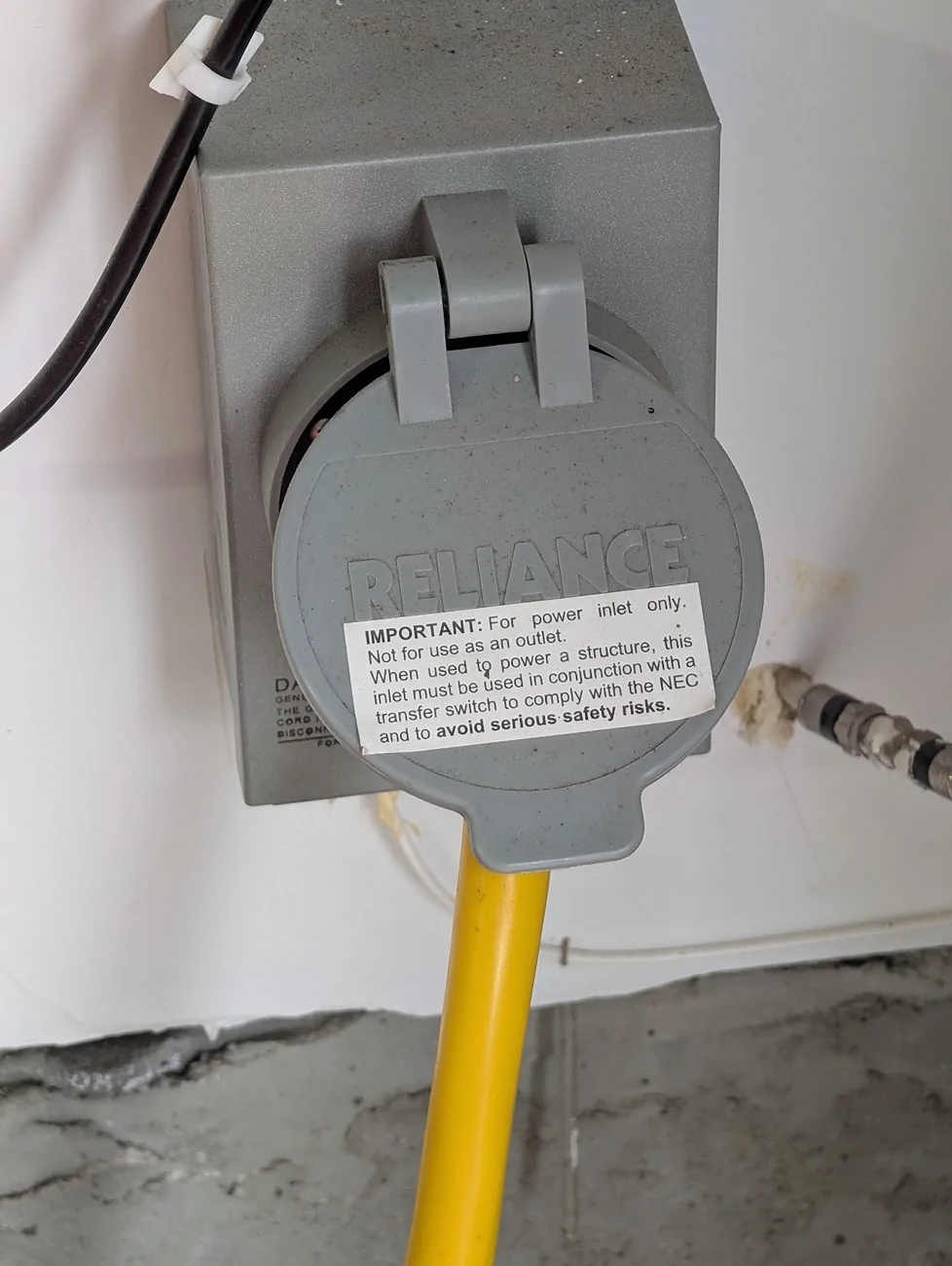

Would be great if they just sold the tiny "Ford Vehicle Connector" separately - would be great to have an "official" option to recommend people to use with a generator inlet and interlock vs having to make your own and leave the ground disconnected (even though that's almost certainly what the "Ford Vehicle Connector" is).
If you call generlink they will sell you just the connector

I think many are looking at this to get a free or reduced price installation thru their electric provider. If you're looking at purchasing and installing yourself or using your electrician, why not go with a generator inlet and interlock? Maybe it's a cleaner installation, but is it less expensive?
An interlock is not an approved ford device. You need the ford connector for your warranty, i am not taking any chances with some product ford hasn't tested

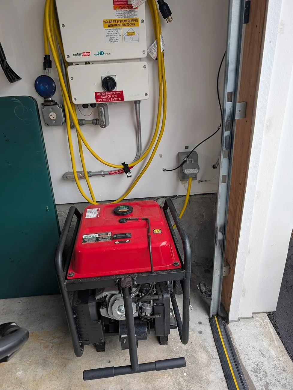

Understood, but it's the same thing. Just the removed ground conductor by a utility company rather than an electrician or home owner. Many people have used their PPOB L14-30 to plug into their generator inlet. Be it an interlock or a transfer switch. There is no way using that plug, as it was intended, should void a warranty. Knowing what we know, that the only thing that makes the Ford system trip is the dual ground paths, and that the way GenerLink has "fixed" this is by deleting the ground in their cable, we have what we need to do this safely. My linetbox and interlock were installed by an electrician and approved by my town building inspection dept. For that reason, it should accept power from a generator, batterybox/solar generator,a Ford truck, or anything with a NEMA L14-30R.

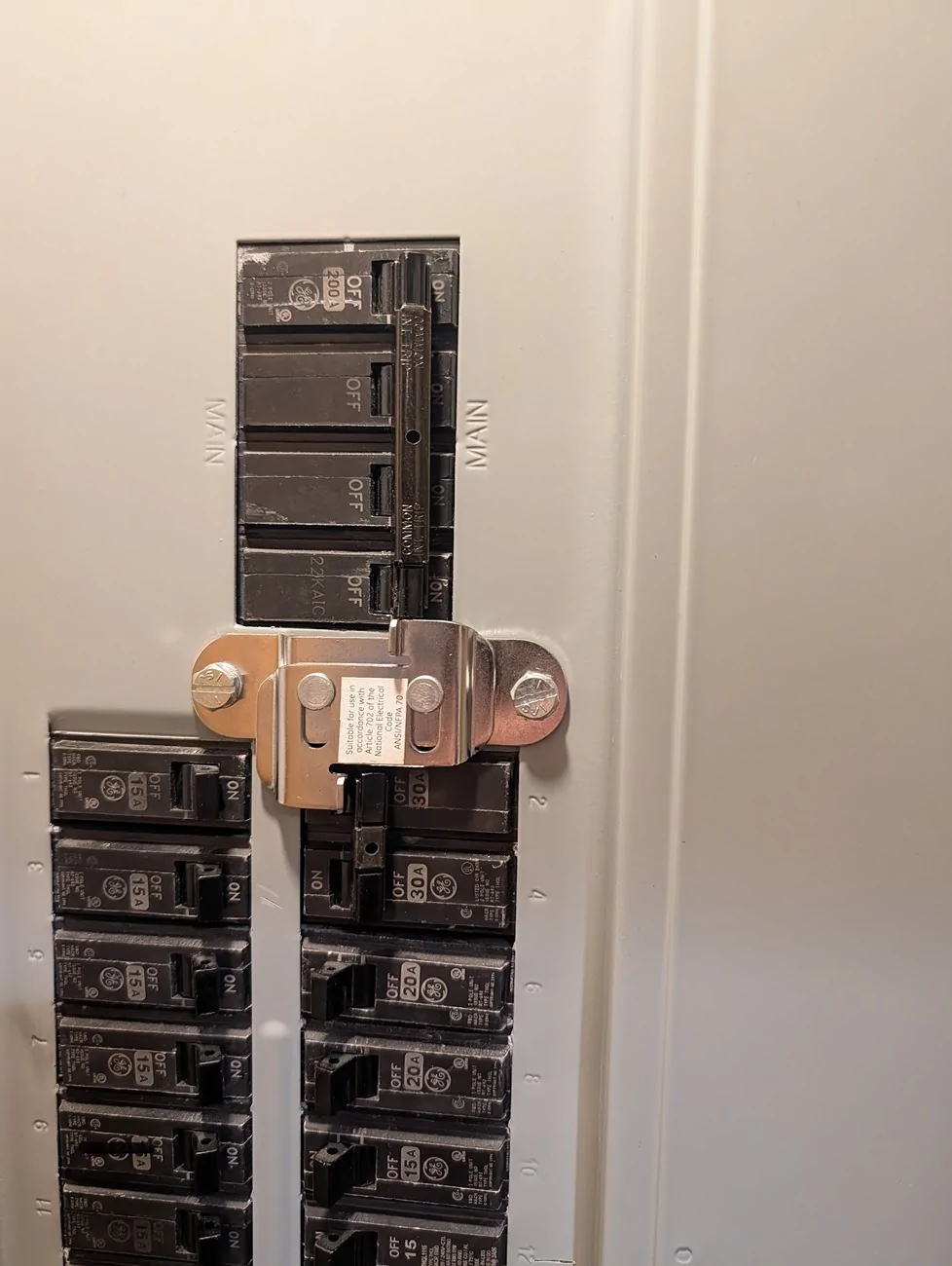

The truck puts out the power, to a house. Since the house has no power, it powers the house. When the house power comes on, it stops. If you have a generator interlock, the house power comes on, you turn off the generator breaker, and turn on the mains.

......................nty. Knowing what we know, that the only thing that makes the Ford system trip is the dual ground paths, and that the way GenerLink has "fixed" this is by deleting the ground in their cable, we have what we need to do this safely. My linetbox and interlock were installed by an electrician and approved by my town building inspection dept. For that reason, it should accept power from a generator, batterybox/solar generator,a Ford truck, or anything with a NEMA L14-30R.

At new home I have a Code Compliant Generator Inlet box installed and a Square-D interlock bypass kit installed by an electrician. The inlet box has 2 hots, neutral and ground connected to the house panel. When I run my gas generator I use a standard. 30-amp generator cable. When I use my Lightning, I use a custom cable that I made without ground connected.
At my remote cabin I installed the same setup, and I've used it at least a dozen times with the Lightning.

Only assumptions, but being that my generator had to be "fixed" by deleting the ground/neutral bond for home back-up, and creating a plug with a connection between the ground and neutral for when I use it as a stand-alone or portable generator for camping, working, etc, this is the only conclusion we can reach.

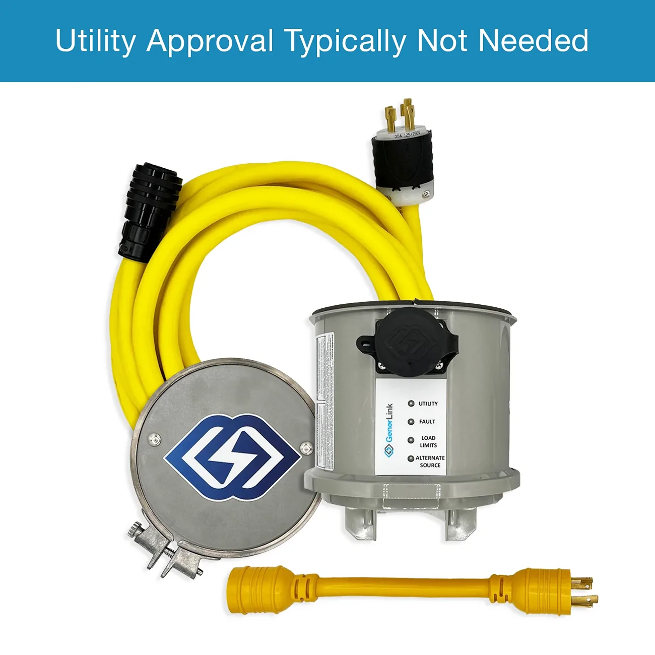

I understand the single neutral/ground bond. I was wondering how GenerLink gets around this. I think I found the secret sauce that allows the Lightning to power the house through a Generlink.
When you order the Ford GenerLink bundle they provide an additional “Ford Vehicle Connector". This must be the short yellow pigtail in the picture below that plugs bewteen the truck and the standard Generlink cable. It must break the ground connection from the truck to the input cable. I wonder if they would sell it separately. That way those of us with a simple generator interlock kit will allow us to use of a standard generator cable?

That pigtail having no ground conductor has been what weve all been saying the whole time.

Ford has stated that the special cable is only with their GenerLink offer.
