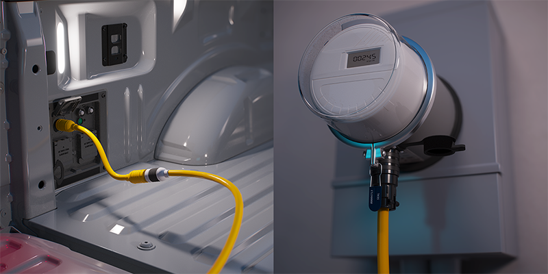

Mark, you drive more than a truck. It can also help be a backup power source for your home. Since your F-150® truck has a 240‑volt Pro Power Onboard™* outlet, you’re already driving a potential mobile power source. Now, Ford has partnered with GenerLink to use that power to help keep your essential home systems running during outages.** We’re excited to share this innovative solution with you, as one of a select group of F‑150® owners in Maryland.
Instead of running extension cords to a few appliances, a GenerLink switch transfers power from your truck directly to your electrical meter — powering your home’s outlets and installed systems through a single cable connection.
Ford F-150 Lightning Out with HIS, in with GenerLink rd+NA_NA_US_SBLFS.162020._cable-image.png__Ford+US
Put your power to work.
Ford F-150 Lightning Out with HIS, in with GenerLink 62020._list_icon_checkmark_small_blue.jpg__Ford+US
Simple: One connection does it all — no extension cords through doors or windows.
Cost: You already own the power source. GenerLink starts at $1,100, plus installation.
Powerful: Power your outlets, lights, and critical systems wired to your meter — like your furnace or security system — simultaneously (depending on combined wattage demand).

I (almost) guarantee that the little pigtail between the cable and the truck is just something that omits the ground connection.
