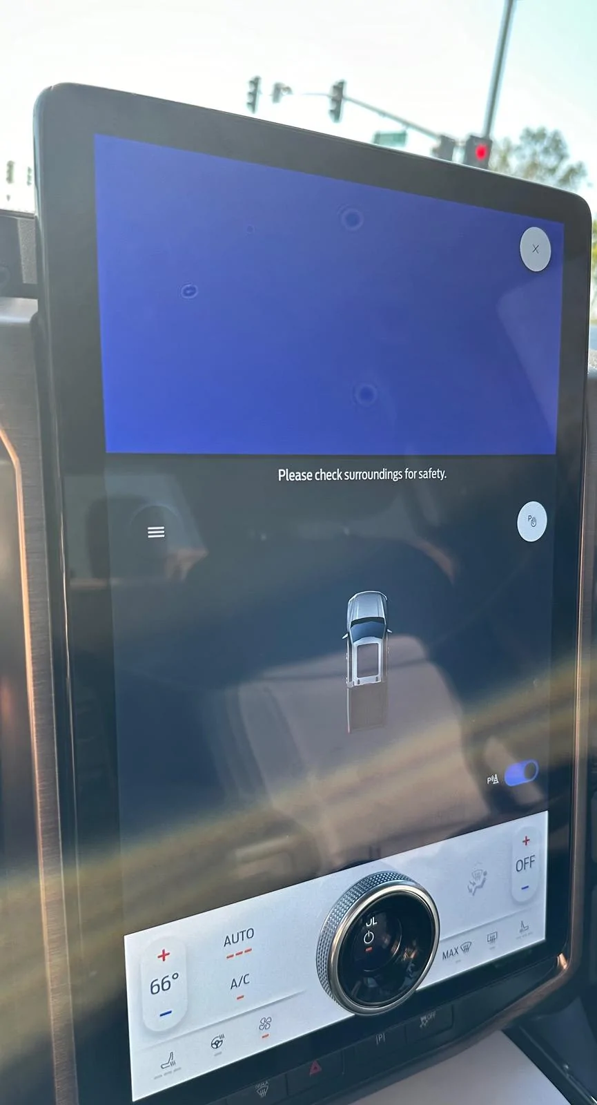

I saw a similar issue on the ford 14th gen forums as well. If the bed camera (the one next to the reverse lights on top of the rear glass). If you park your truck facing the sun and it’s hot, the display on the truck shows a blue screen or rainbow lines. If it’s cooled down again it works.
I’m going to take this to the dealer soon but you guys should check on your camera too.

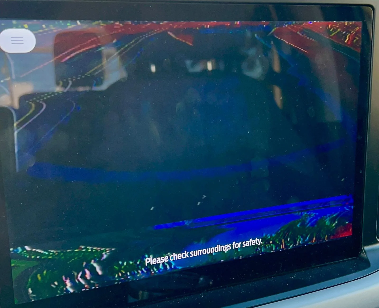

After dealing with the issue intermittently for several thousand miles, I waited until the camera was failing most of the time. My displayed showed the solid blue screen most of the time, but it also occasionally showed the black screen with rainbow lines shown below.

I finally decided to check my bed camera after work. Sitting in direct AZ sun for 2 summers...that thing is toast. Nothing but a blue screen. Checked it again this morning to see if it was just temperature. Nope, still toast. Wish I'd checked it earlier to get fixed when it was in the shop 2 weeks ago. Oh well, an excuse to have them take it and do the frunk module update I guess.
