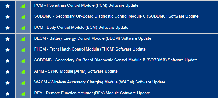

Well here's the list as it stands now:
Ford F-150 Lightning Phone as a Key issue 1FTVW1EV3NWG03253-12-Oct-22
3,771
4,851
I had to go with a sad icon to see that list, but a huge thank you for checking.

Well I certainly understand. They didn't do any programming but they did a lot of reading up on the HVAC system and doing pinpoint testing of the electrical outlets.

Oh and there are some updates that cannot be currently updated by an OTA. The GSM, WACM, and DSP are three that come to mind.
So gearshift module, wireless charging pad, and audio digital signal processor have to be done using FDRS. There are more, but those are the three that come up the most often.
