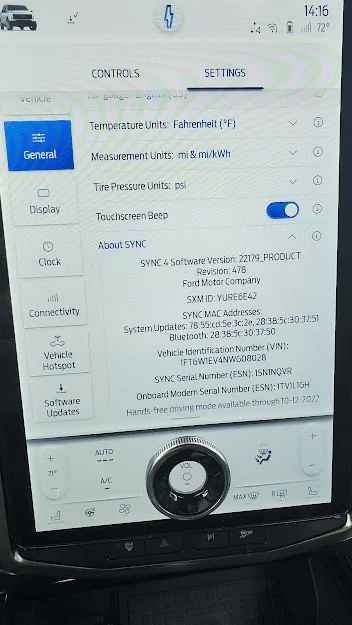

Where can you see the sync version?
Under Truck, Settings, General button, expand the chevron "About Sync"

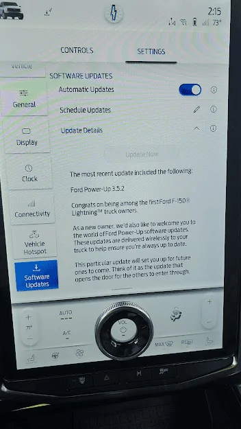

Unfortunately the Power Up version only appears for a few days under Truck, Settings Software Update, Update Details for a few days after the update has processed. It would be nice for them to leave a current version listed
